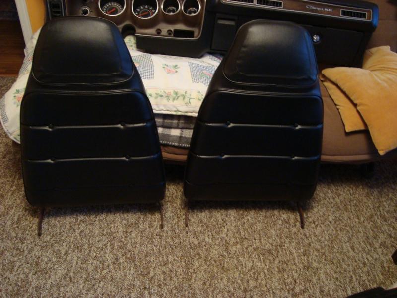

here are the uppers recovered with ledgendary seat covers going to put them together this week

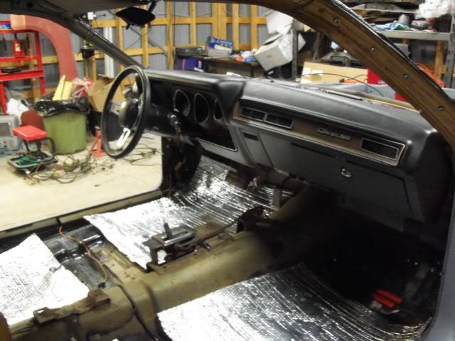

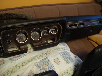

here is a shot of the dash almost ready to go in!
Looking great! Ive heard a lot of good about legendary interior..And I think a lot of the overhawlin shows Foose had them make some things, always looked great..Going to be a nice ride. Im back in the watch mode so good luck!

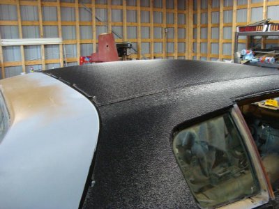

ok i have some more pics here we are warming up the top before install. i have to get it put on now so i can get the windshield put back in not the way i wanted to go but oh well

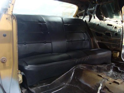

had to weld in a new pan on the passenger side and a new hook on the drivers side, the seat bottom was from another car as well so i just wanted to be sure it all fit! those are fresh ledgendary covers they are real nice!

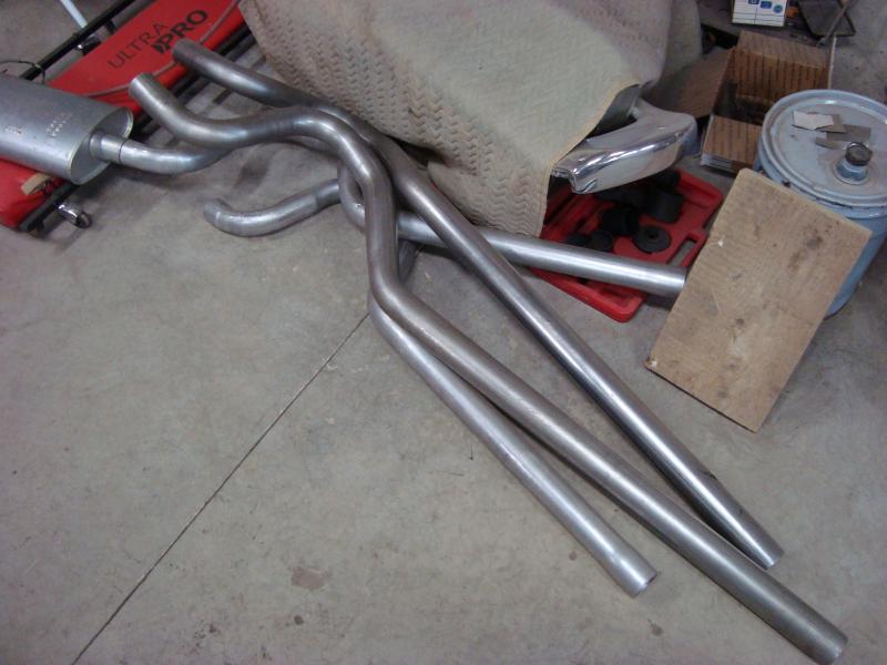

here is the exhaust i will be using i have a choice on the tailpipes i can use some from acurate or some custom stainless ones once i get the rear tips i will hang the pipes and see which ones i like more.

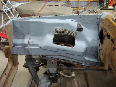

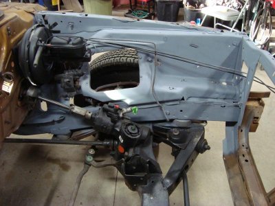

i blasted and primed the inner fenders, i think i will hand sand the firewall. the door jambs got the same treatment soon i will get them painted so i can drop the motor in and get this thing going. it had no motor or tranny and the whole wiring harness has been swapped as well so i want to get a head start on it in case i have gremlins

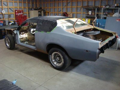

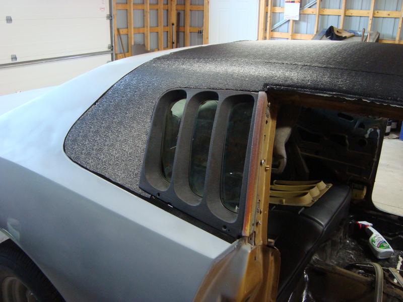

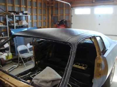

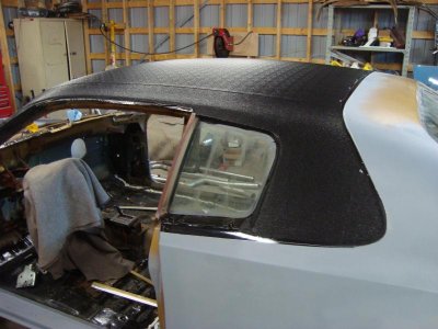

Got the top done last night it looks awsome had a friend of waygun's come over to do it as i had never done one before and i paid big to get the real top

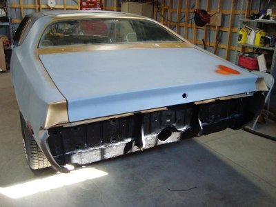

did some test fitting on the deck lid as well a bit more to go on that yet
That pattern in that top looks awesome!!! I see why you shelled out the extra cash. Looks great!
Thanks there Prop even though it is being done to my tastes instead of totally correct i am picky about some stuff and i remember the look these had from my younger days so i really wanted an original top.

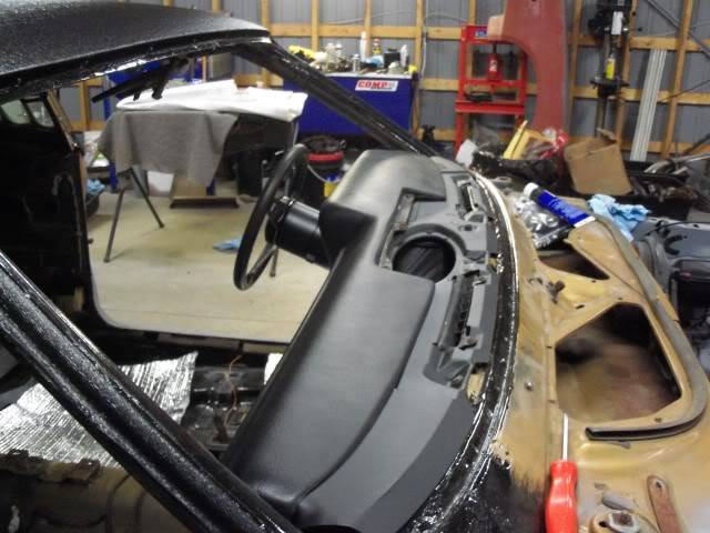

Made big progress Friday night.

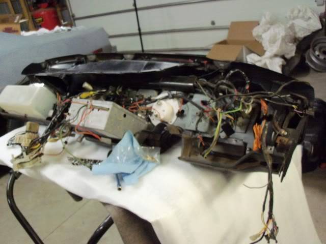

Got the refurbished harness installed in the dash.
Charger360 got new bulbs to the cluster.
I found it easier putting in the harness in the dash prior to mounting the dash into the car.
We got the heater box and related hoses,wiring installed prior to mounting the dash.
We took a break sitting in the back seat right after installing the dash.
I got the task of hooking up everything under the dash,and cleaned up the routing for a nicer looking dash.
HVAC controls,tach wiring,raised the column and plugged it back in.
Looks purdy.
