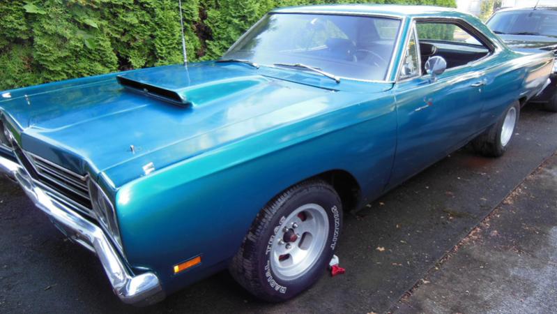

My brother-in-law and I strap towed my Roadrunner over to his house this Saturday evening (about 1 mile away). We got the front end up on blocks and the rear end up on ramps so we could get underneath it.
We started on it in the morning on Sunday and removed the fuel tank and all the rubber fuel line. Checked and cleaned the tank, reinstalled it, changed all the fuel lines (rubber) and cleaned/blew out the steel lines. Replaced the mechanical fuel pump (old one wasn't working) removed the electric fuel pump on the frame rail (wasn't hooked up). Put the alternator back on. Placed a borrowed E-brock carb on it and started cranking it over. Fuel came up to the fuel filter by the carb fairly quickly so we knew the fuel pump was working so we connected the line to the carb.
Cranked it for about 5 seconds and she fired right up! :headbang: Got it off the blocks and double checked everything. Warmed it up to make sure we had coolant flowing. I took my first drive back to my house to show my wife! "See, not all my cars are dead in the water" :argue: She was actually pretty happy for me. Drove back to my bro-in-laws.
I could barely find the gears the first time as the shifter is really sloppy. It also has a miss and a lifter tick. Took it out once more to get more gas in the tank. Man, what a great feeling to have a car that can drive, even if not really well. :upside down: Back to it tonight to pull the valve covers to check the lifters and maybe try to adjust the shifter.

whats the info on your runner?
you never forget your first!...congrats...i know that feeling all too well! glad ya got it!

Basket Case, you've seen it in other threads along with the story so I won't re-bore you.
