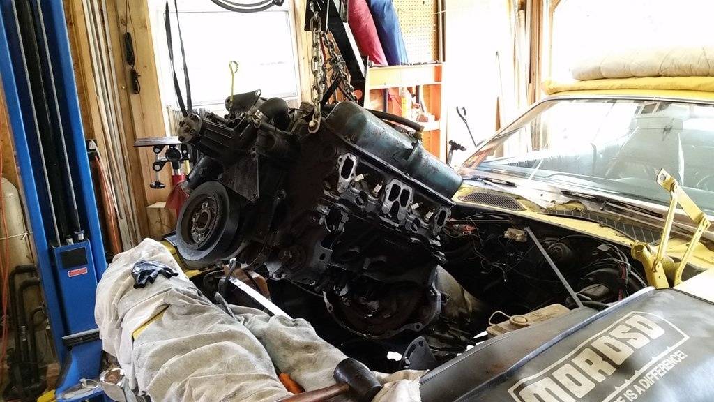

Here is a pic as we were pulling the assembly out of the car:

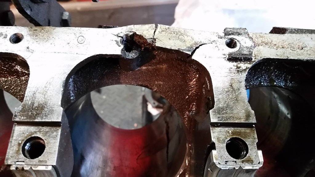

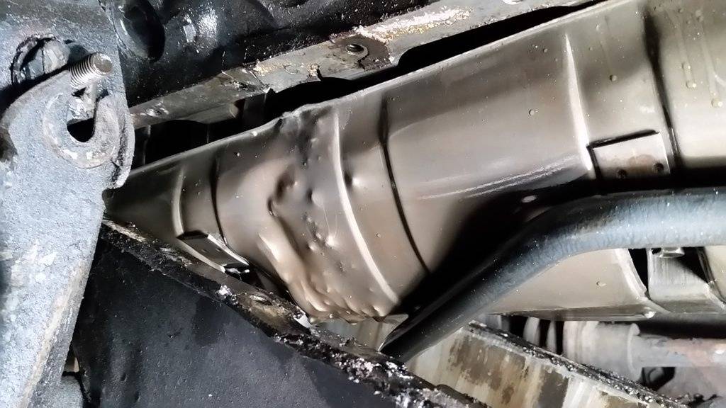

First indication of major carnage was the windage tray. Note also the nice "dent" in the block along the oil pan mounting flange.

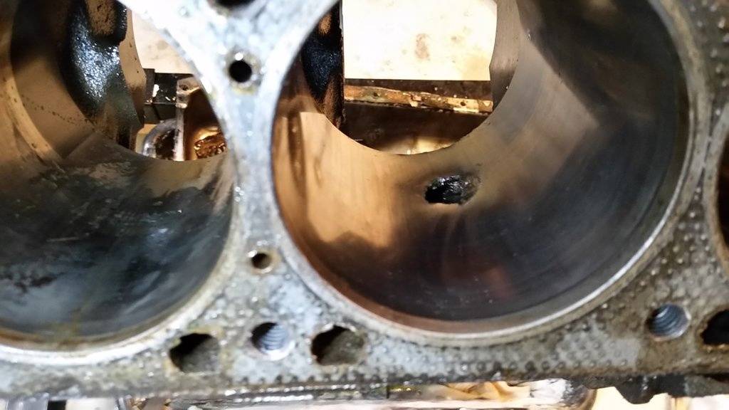

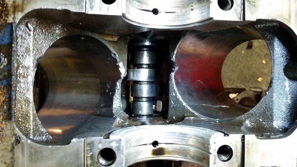

Once we got it separated and on an engine stand, the damage was clear. Note again the cracked block in the lower part of the picture where the oil pan mounts to the block. The casting is of course beat up on the inside too.

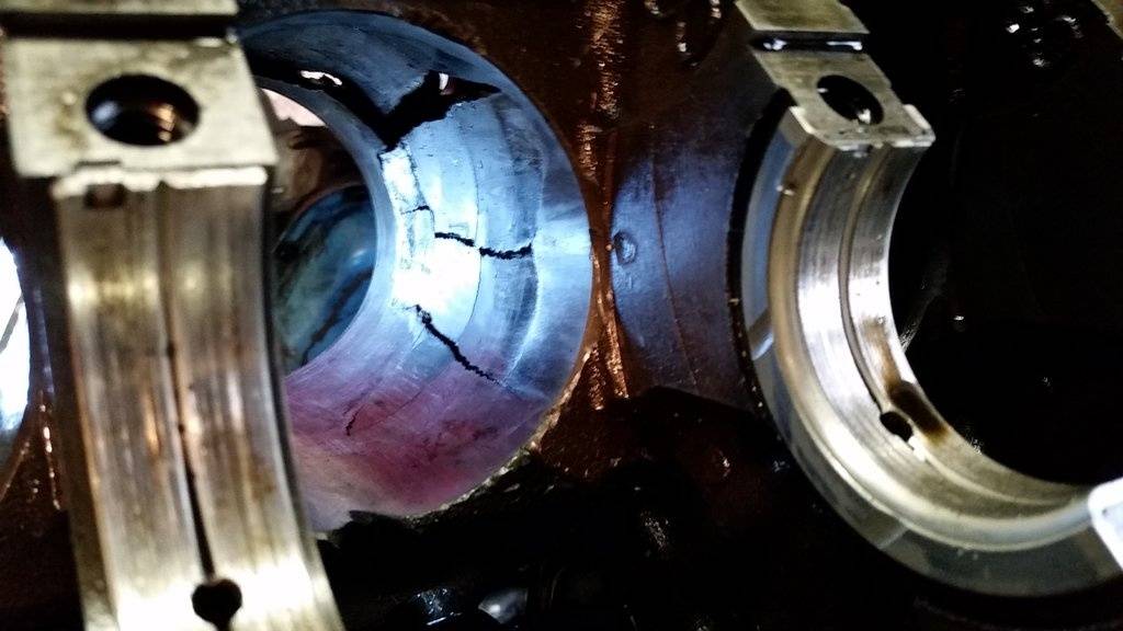

If you look carefully at this picture, you can see a crack that goes vertically up the most of the length of the cylinder #3. #4 let loose but #3 took the brunt of the damage.

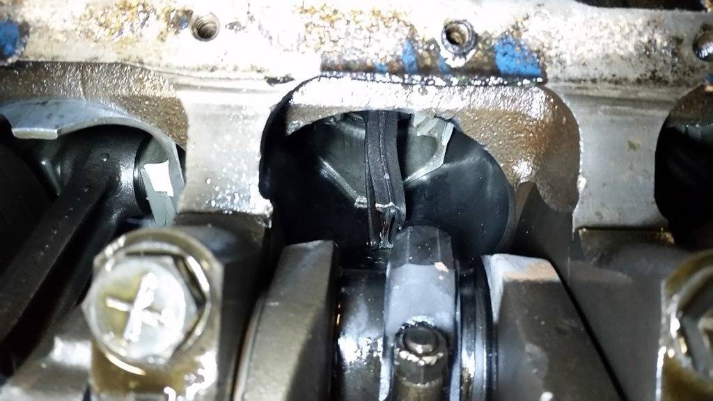

Here is #4:
So unless anyone can tell me different, this block is DONE. It can be a nice boat anchor. My current plans are to strip the block down and toss it in a corner somewhere, in case ever someone wants to spend the time and money to fix it (if it even can be fixed).

can see crack in pan rail.

...And sorry, the pan is no good. Pickup is fine though...

OK, my son and I managed to strip the engine down and get the crank and pistons out. It was a bear getting #3 out. Let's just say the #3 cylinder is VERY thin wall now...
Here are a couple of pictures: First, here is a shot of the pan rail crack from inside and outside.

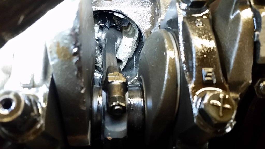

Here is #3
And #4 took a shot too
And some chunks out of the block too
My best guess is the the bearing for the #4 rod died, and likely sent some parts through the engine. The connecting rod then let go. When it broke, it jammed the #3 piston into the wall of the bore, cracking it.
The bearings did not look good, especially the rod bearings. We had an oil problem a few years ago and the block was sucking oil from underneath the intake manifold and burning it in the cylinder. For one trip, it very nearly sucked the sump dry. I'm wondering if we hurt the bearings then and they have just taken some time to completely fail...

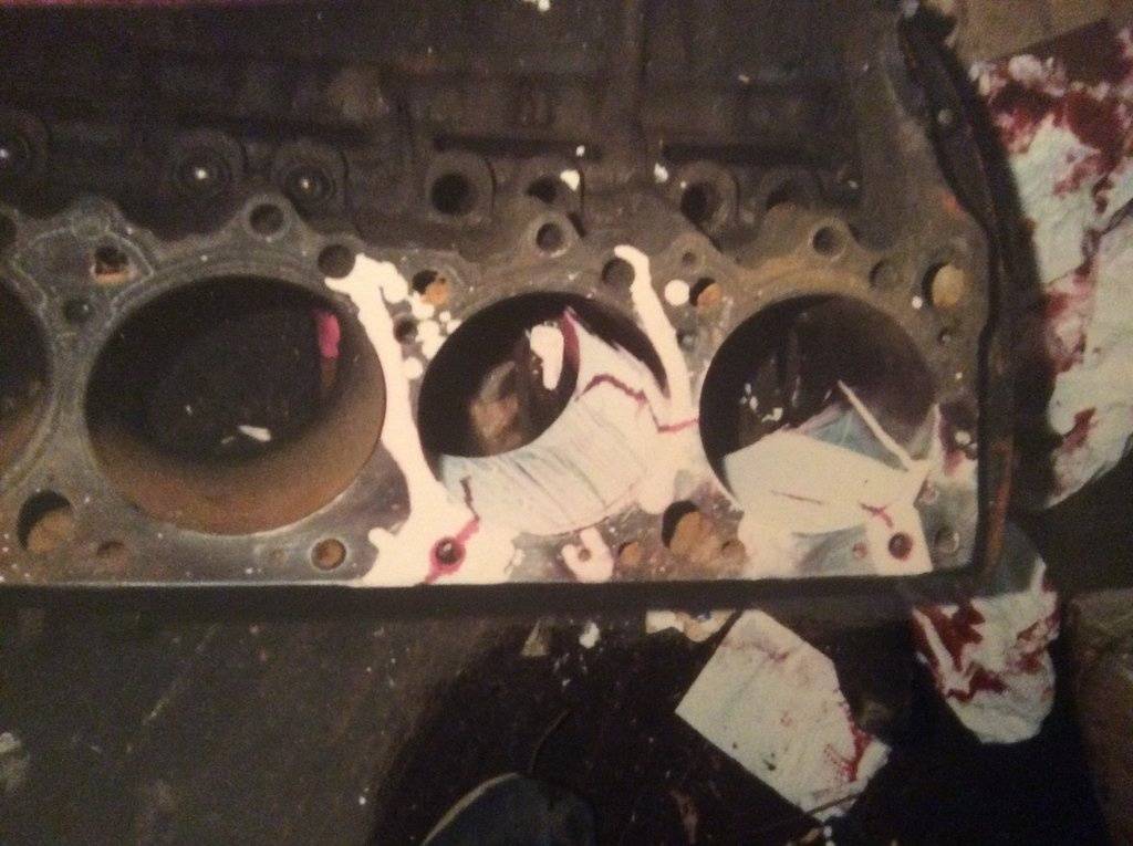

IMO it's fixable, worth fixing now, no. 2 sleeves fix the pan rail and align hone the mains. Honing the main may be necessary because of the whack on pan rail, just my opinion. Put the block in the corner, keep it with the car. I'm in the same boat but I have a little more water in it.
