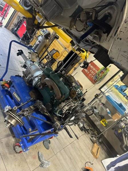

Engine will come out for sure at the point. Im going to drive it for the next month, if it lets go it lets go. After the month it will just get rebuilt the correct way. Thank you all for the help. Ill let you know what we find once the motor comes out.
