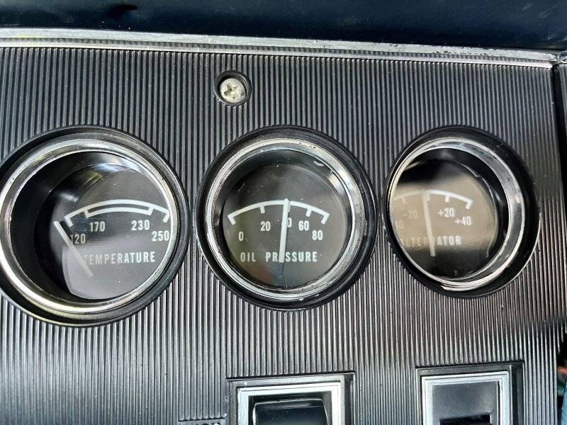

So this past weekend I changed the pump for a stock volume and pressure pump and pick up tube. Cold start it goes to 40psi and hit idel it goes to 5psi. Barley registers on the factory gauge. Any ideas? Motor seems to run fine and no blue smoke from the exhaust. Bad bearing or oil galley plug?

So, when I bought the car, I was told the engine was rebuilt. Don't know if its true or not as the guy lied to me on a bunch of things. Maybe his version of rebuilt was paint it and make it look new. I changed the pump and pickup tube as I figured it was an easy and fairly cheap way to see if he used an old pump and packed or pinched pick up tube. I also went with 20w50 VR1 for the oil. The oil pressure on a cold start improved but hot idle the gauge reads 0. Hooked up a mechanical one and it would dhow 5psi

Here is the oil pressure at cold start up.
I still say everything could be fine. When people get low hot oil pressure they think they have a "bad" oil pump. No. These oil pumps almost never give it up. I started a 55 year old Road Runner with the original oil pump a few months ago. The pressure relief was stuck. I don't know how much oil pressure it made, I'm guessing over 120psi. It ballooned up the filter, then blew the rubber filter gasket out and dumped all of the oil on the ground. It looked like a 3 stooges movie. I tore down the oil pump, the gears were all gouged up. You would wonder if it would make any pressure. I wonder if I have ever seen a "bad" pump. It's usually something else. I'm still under the impression that there is nothing wrong with your car. I think it is over 50 years old, it's oil volume needs have changed, and you aren't listening to what it is saying to you loud and clear. It's saying, "Why did you come home with a stock volume oil pump when I already have one of those? Can't you see my gauge? Read my lips. My needs have changed, my clearances have increased from old age, you know you ain't the man you used to be either dude. Now go get me a HV oil pump like I clearly told you I wanted."

So, that is a known good aftermarket mechanical oil pressure gauge?
I would try another gauge
