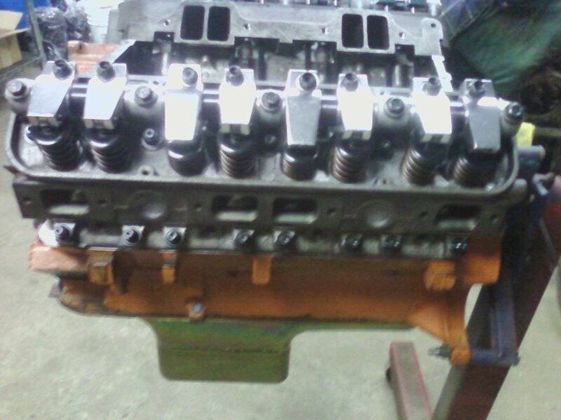

I have an old build with near (?) zero-deck 4.290" 0.040" over flattops
2 small valve reliefs (6 cc's ?) don't remember the #'s
I think they were like Speed-Pro's forgings/maybe Venolia's
(bushed the pin end of the rods for free/full-floating)
IIRC like a 1.95" (ish ?) compression height, with castiron rings
good Clevite tri-metal bearings
ARP rod-bolts (resized rods) & main cap bolts
(ARP hardware everywhere)
OE windage tray, hi-volume Mellings oil pump
dual remote K&N filter
3/8" pickup 7qt/7" deep Milodon/shallow pan
Edelbrock RPM 84cc (maybe 80cc's) 320cfm @ 0.600"
mildly ported/mostly pocket & un-shrowding the valves
had to notch the cylinders for best flow
to not upset the intake valves flow (on a smaller bore)
with a 0.039" Felpro gaskets (Felpro gasket kit everywhere)
IIRC about appr. 10.2:1 final compression
OE 3.38" steel forged crank, balanced/polished 0.010" under

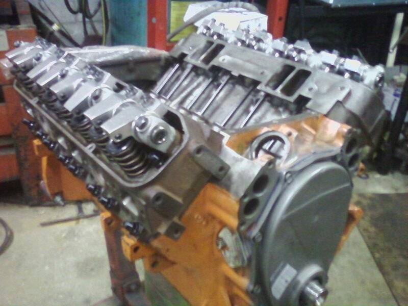

Crane Hyd. Roller .520" int/542 exh.
276/284 dur. w/matching springs
MP Double roller gearset/timing chain/with roller cam button
IIRC set 2* advance 110*
Smith Bros. cup/ball 3/8" hardened push-rod
(don't remember overall length)
& Crane Retrofit Hyd. Roller Lifters (great lifters)
Crane Super Gold 1.6:1 Roller rockers
it's good to about 6200rpm
rarely ever sees more than 5800
