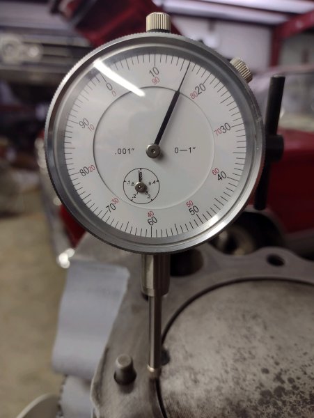

The 67 383 that I recently built is still standard bore, and the flat top stock pistons are 16 thousandths in the hole. I went with, I believe 020 steel shim head gaskets on the stock 516 closed chamber heads with the 1.60 exhaust valves changed to 1.74 with a little port work. The cam I chose is just under. 500 lift so no geometry changes needed.
The 67 383 that I recently built is still standard bore, and the flat top stock pistons are 16 thousandths in the hole. I went with, I believe 020 steel shim head gaskets on the stock 516 closed chamber heads with the 1.60 exhaust valves changed to 1.74 with a little port work. The cam I chose is just under. 500 lift so no geometry changes needed. View attachment 1792891
Should make for a strong running 383.. Unfortunately steel shim gaskets are kinda hard on aluminum heads...
