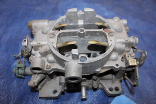

1967 Mopar 383/325 HP
'Stock' Carburetor
Carter AFB #4999S
* Primary ......... 1 7/16" ....... Venturi 1.186" ....... Jet Size .0890"
* Secondary ..... 1 9/16" ....... Venturi 1.313" ....... Jet Size .0689"
* CFM Rating .... 566

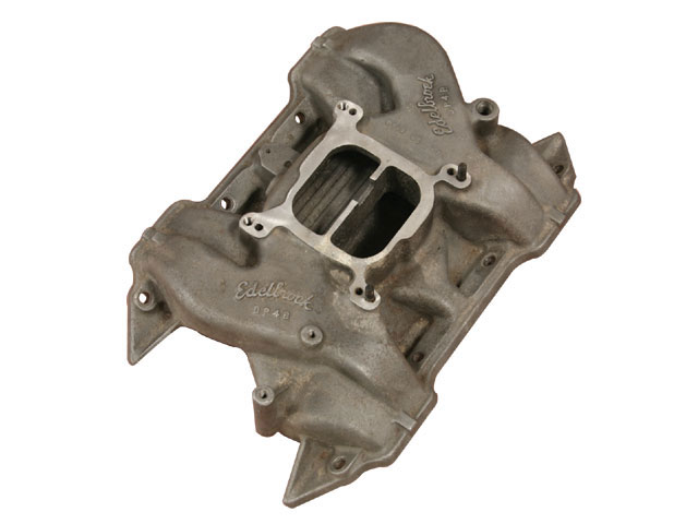

Running this 'smallish' Carter AFB on an Edelbrock Performer RPM would 'not' achieve optimal
performance for the 'stock' 383/325 HP, as the Engine is 'tapping-out' at 5000 RPM's.
