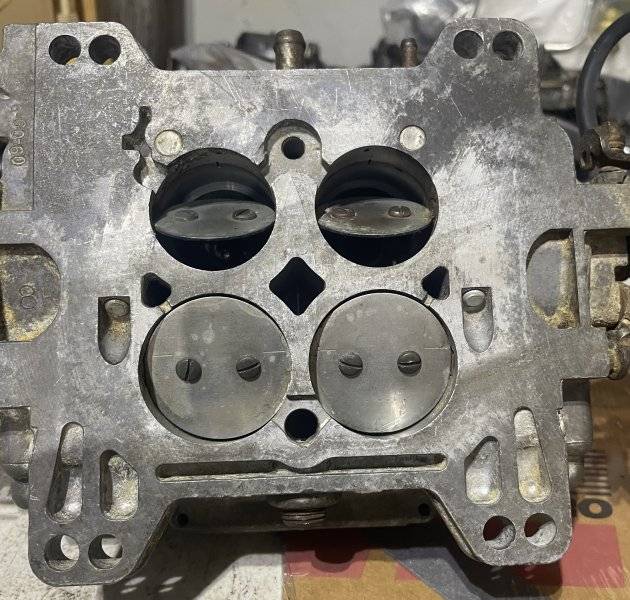

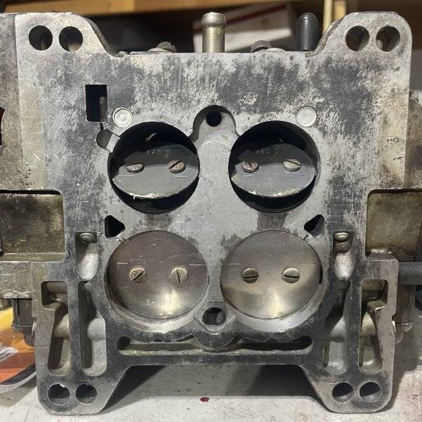

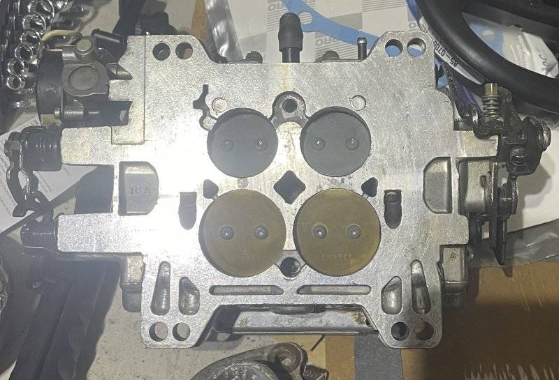

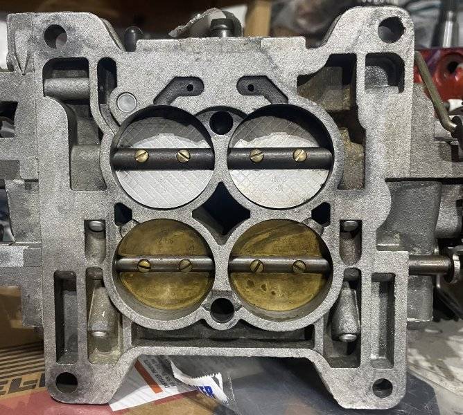

A FWIW mention, some AFB and maybe AVS carbs are solid in the center while new models have a open space.
Below, in order;
1; Carter Competition 625 AFB - 9636
2; A later year Carter Comp 625 - 9636
3; OEM Carter 4429
4; Edelbrock 1806 AVS
Notice the centers.
