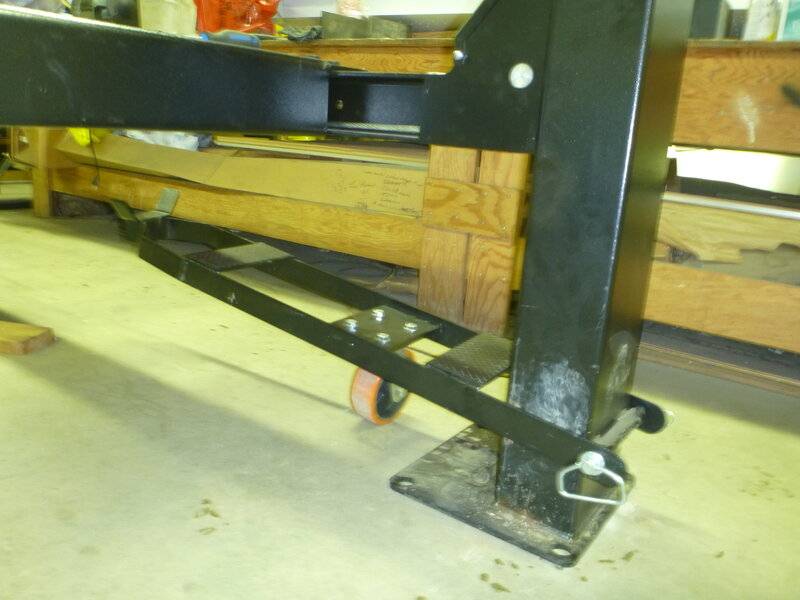

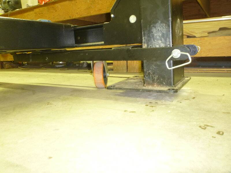

Note at Step 3.. 1. in brackets (if not bolting to the floor skip to item 3).
No need to bolt a 4 post to the floor unless you're using it for daily commercial service. Be kinda dumb to do so, if yours came with the lift rollers to move the lift around if you want to.

thanks, i really didnt want to bolt it down, but, this unit does not have the rollers as an option
yea, i called bendpak and they said they wont fit this model.. dont know why they put the pics in

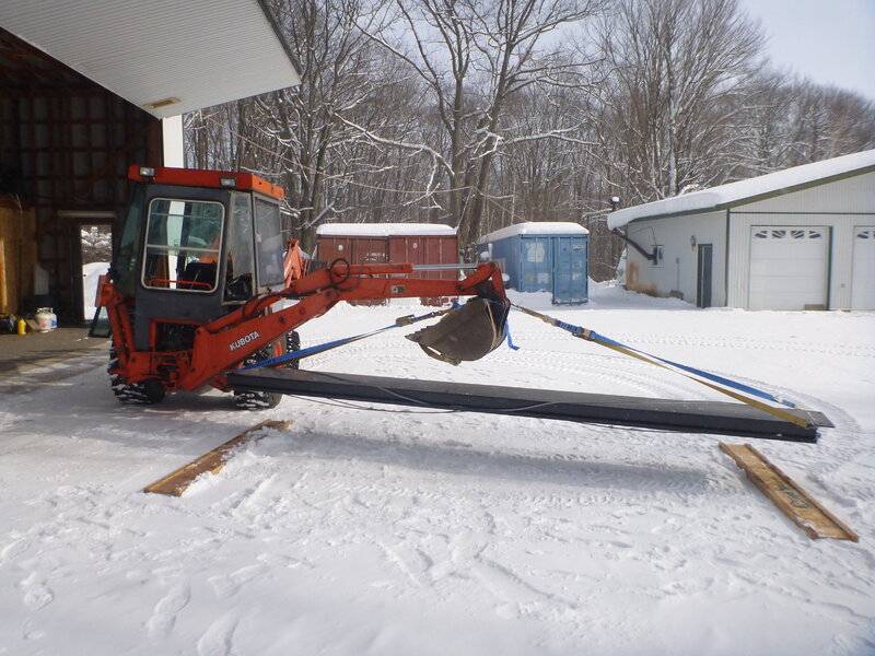

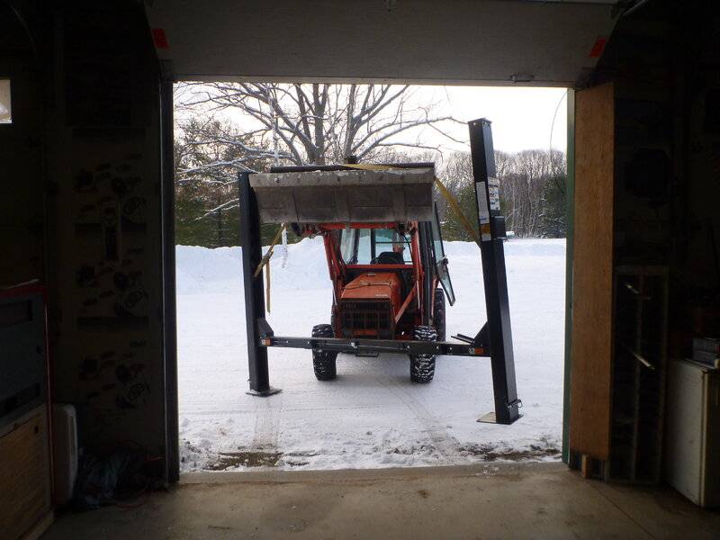

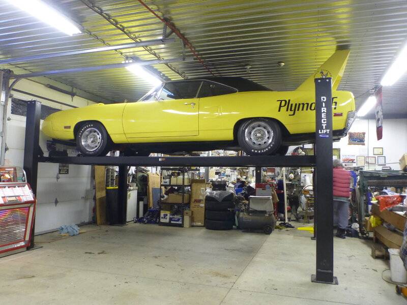

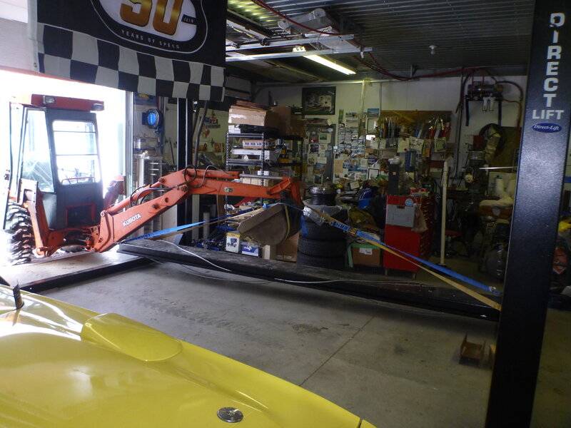

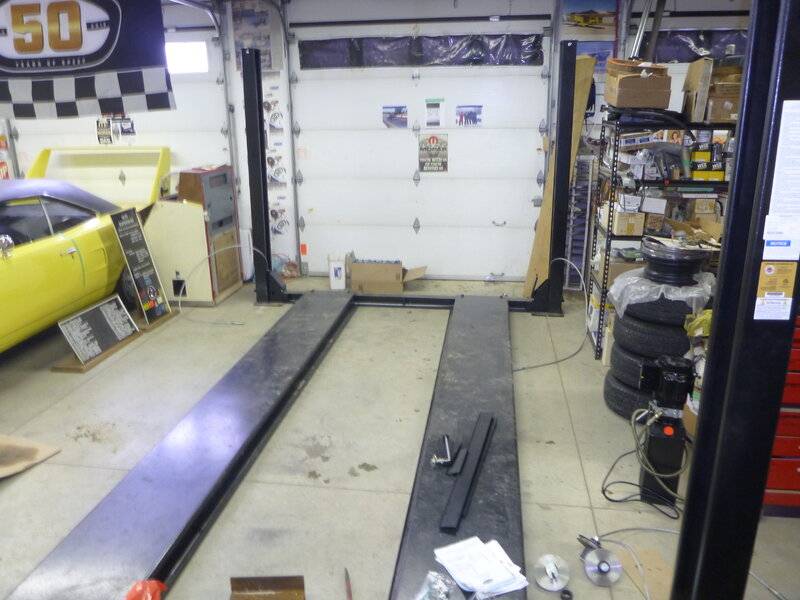

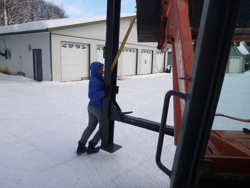

I presume that's you and some friends helping him lift everything into place. Took 4 of us to lift a deck plate and 5 on the one with the lift cylinder in it when I picked mine up second hand. I used my "helper" to assemble it back together and my wonderful other helper to walk my assembled posts into place.

think i'll spring for the 850.00 install, i dont have any heavy equipment to do the lifting , and i dont want to throw my back out.. again.. trying to lift it

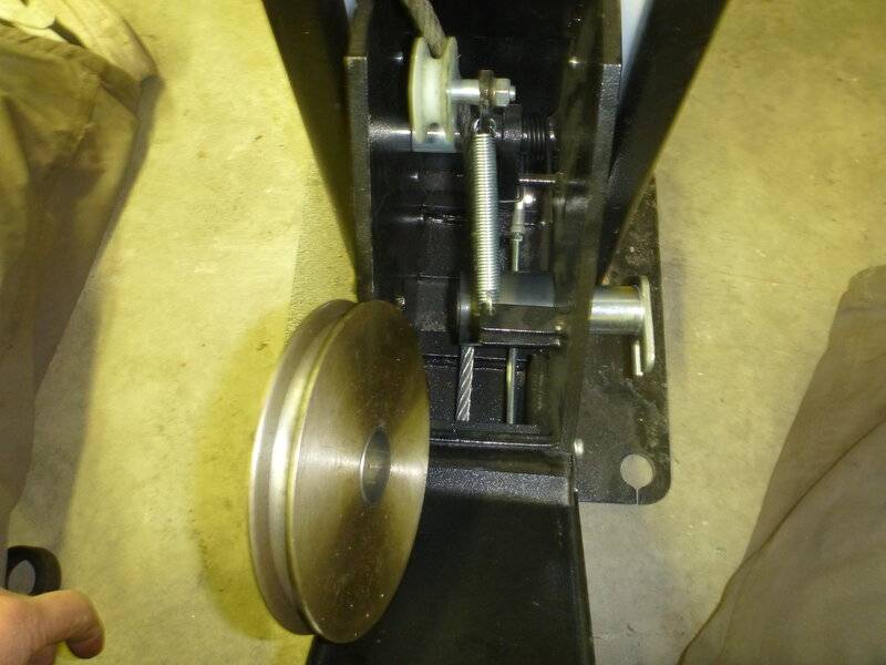

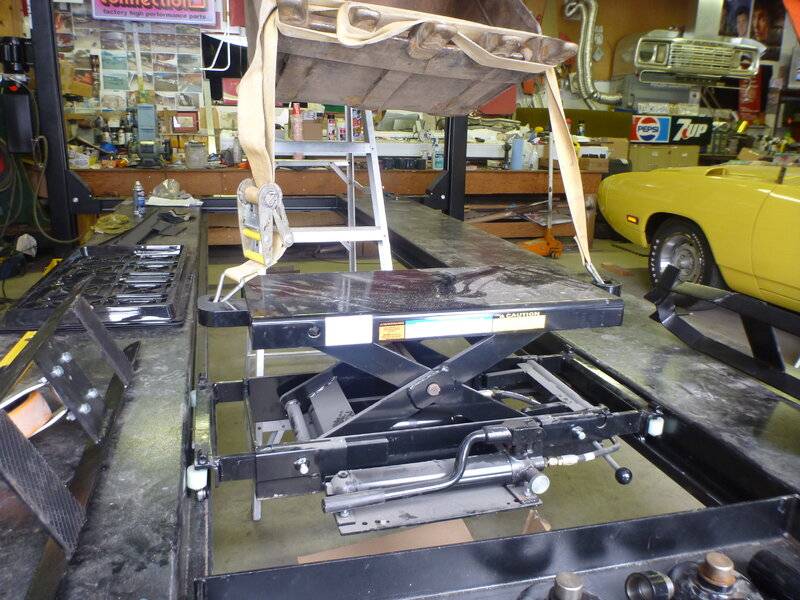

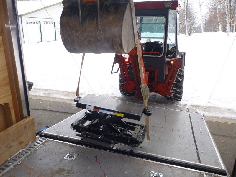

Just make sure it's clear what he's doing and what he expects out of you. None of it is light. Even my jack weighs 340lbs...

I have the 9000 pound version Bendpak in my shop. It is very doable if you read the instructions, three times. I assembled mine, wired it, ran it a few times, then bolted it down. I put it in 2009 and has 13,000ish cycles on it.
