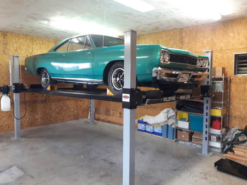

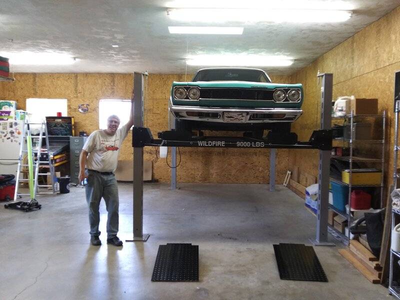

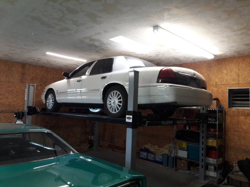

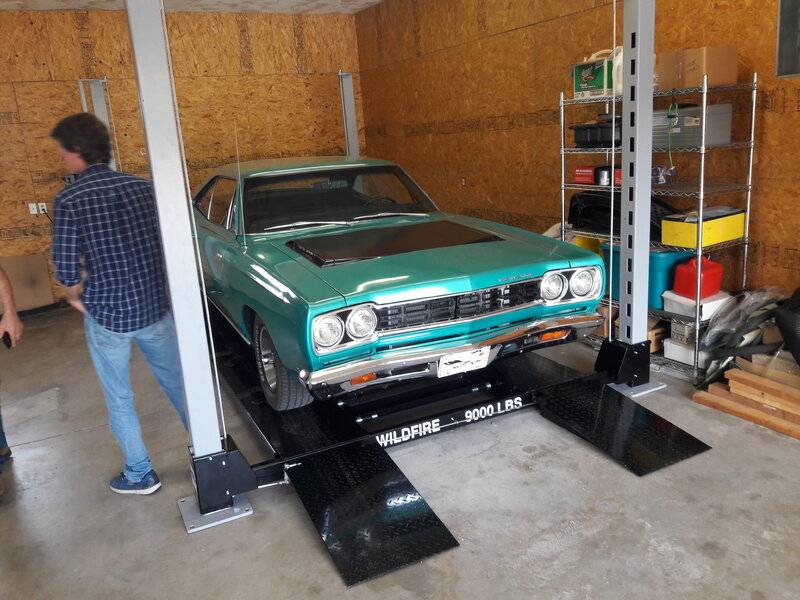

Well all total it was about 6 hours start to finish for 4 guys to unpack and assemble. Need to relocate a ceiling light to go higher. Cables need a slight adjustment to level. Two of the guys that "brand x" lifts kept commenting on the excellent quality of the wildfire. I'm happy with the puchase.

Well done, you will enjoy it. The Wildfire appears to be the same as the Advantage 9000# lift I have. They probably come out of the same factory. I am very happy with mine. As to adjusting the cables, what I found sped up the process and cut down on re-adjustments, was to park my heaviest vehicle (Ram 2500 Diesel) on it for a couple of days to stretch the cables. Just raised a foot of off the floor. Then I put the car that would normally sit on there up and adjusted accordingly. I have not had to revisit the adjustment in 5 years.

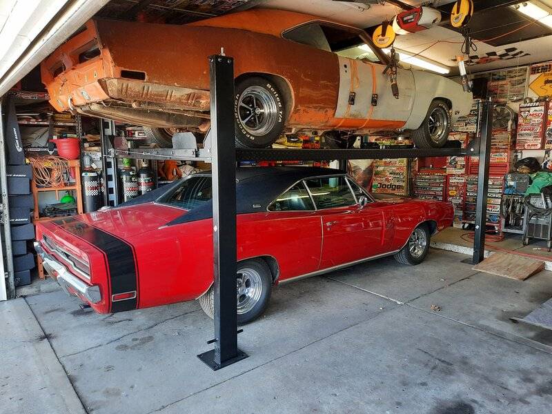

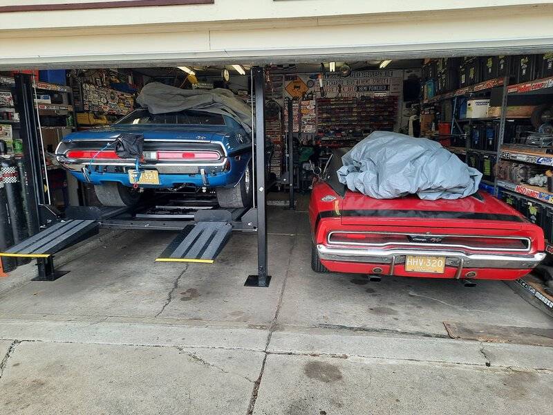

As I posted in another post. Mine is an Advantage brand. It's tight but it all fits with 10' ceiling.

I really wanted turn key installed, but with 4 guys, a borrowed trailer, a borrowed engine hoist, and a bunch of bubba burgers it was a fun job. Having two of the four guys experienced with building their own lifts helped immensely. I've volunteered to help build another one.

So far I'm still happy. Did my first oil change using the lift on my trusty grand marquis last weekend. Couldn't believe I could do an oil change in about 15 minutes.
