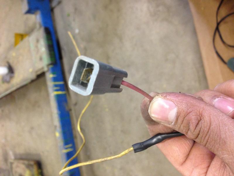

Not sure where this wire attaches to on my 68 b body. It ran under the carpet together with a yellow wire from my four speed console to im not sure where under the dash. Thanks image.jpg
Wondering where it connects to on the harness. Cant find it on my schematic. Thanks

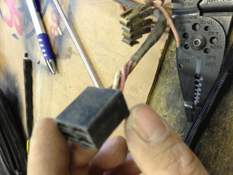

Found the harness in my old wiring mess. Why is there a yellow and white wire on the connector. I thought the reverse lights are run through the wires on the back of the tranny then underneath the car not in the consoleimage.jpg. Thanks
rev light work off a switch on the shifter,on 68 & older.
On a 4 speed car? Thanks. What is the 2 prong plug on the back of the tranny for? Thank you
Hi, The switch on the back of the manual trans is for the reverse lamps. They run up the trans to the bell housing and into the wiper harness bulkhead connector. One is power out to the switch on the trans and the other one is power back to the reverse lamps.
sorry i went brain dead,,,,missed the 4 speed part.
Thanks guys. By any chance do you guys know what the 4 prong harness is for? It piggy backed 4 other pink wires off the fuse box. Has a white purple orange and pink goin to it. Thanks
Thanks. Im gonna run a pink wire from the fusebox to the center console and tie it in with the yellow ground wires so when i open the door the console lights come on.
In the pic i posted there were about 5 pink wires piggybacked together in the fusebox for the accessory lights
yes & that plugs on the back of the fuse panel, they plug on the 2nd from the left male spade on the back of fuse block
