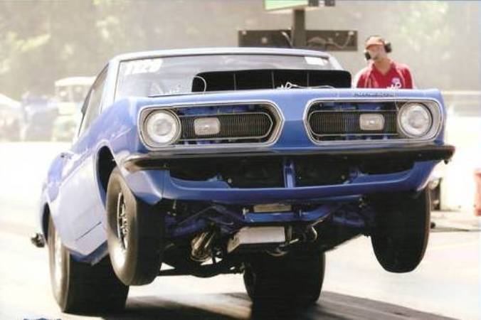

When I started we ran a hemi box and various cuts up to the last being the face plated setup by liberty. I have cryo'd entire units, mikronited and whatever else. They shift smoother but ultimately still break. This was in a 3300lb 68 Cuda running mid tens.
As always with a stick just as important as the trans is the clutch. For a dedicated drag car sintered iron and adjustable PP are the norm.
Right now in my Cuda I run a gf4a g force four speed and a Ram clutch. It got to the point between breakage with stock pieces and availability it just wasnt worth it. I've put 500+ passes on this setup and its been great. Best pass of 9.93
It'll be a cold day in hell before I run an auto. The clutch setup at first takes a little learning but is not rocket science and most any four speed guys are always willing to help.
You can put a complete setup in a car for 3500-4000. Used Jerico, new clutch etc. I see tons of posts by auto guys and it just seems they have tons of money in converters and always pulling stuff apart. Just my two cents though.
Here's an in car of mine last year, first pass of the year, I was a little off on pushing the clutch for third-but damn its fun.
