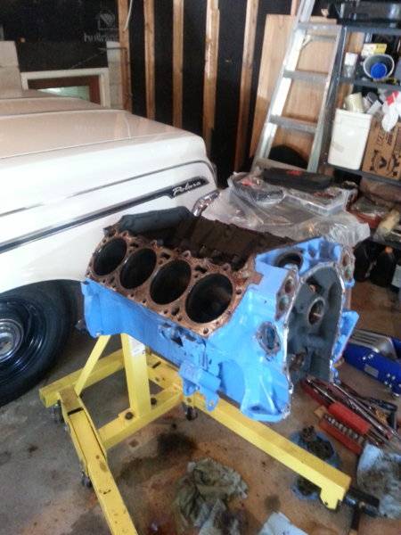

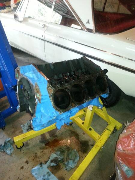

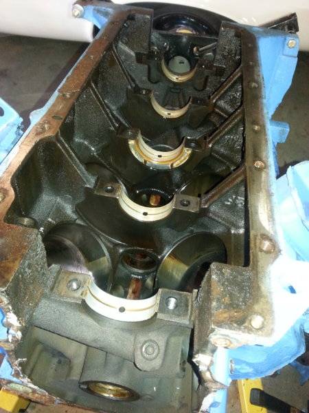

more pic's to come. The engine was still sitting on its 1976 bearings.

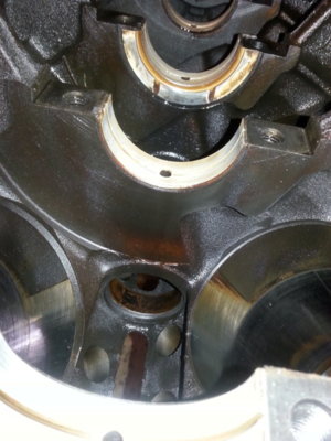

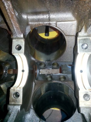

Well it's almost ready for the machine shop. I just want to clean up some casting flash and smooth out the oil feed passage. Do you guys have any block prep tips? On the big block mopars do you guys put a small hole in one of the plugs behind the front cover to help lube the timing chain or is that a Chevy thing?
Never had any timing chain lube issues with many thousand runs with a stock system. Flashing cleanup especially in the valley area is good thing.

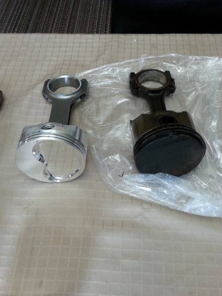

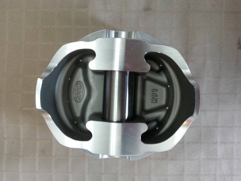

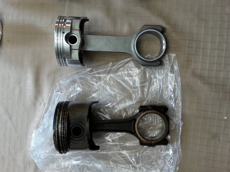

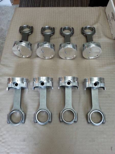

I got my rotating assembly. It's not hard to guess who makes the rods and pistons. Does anyone know who makes the cranks? I test fit all the pins and they all fit perfectly. I'm going to be slowly getting the parts that are left to get for the build over the course of the winter.
