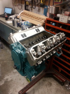

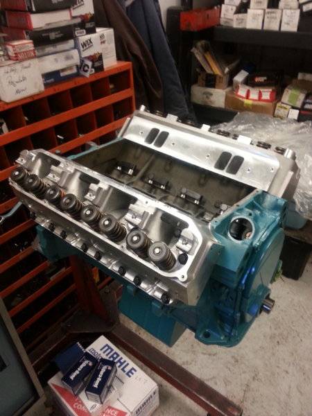

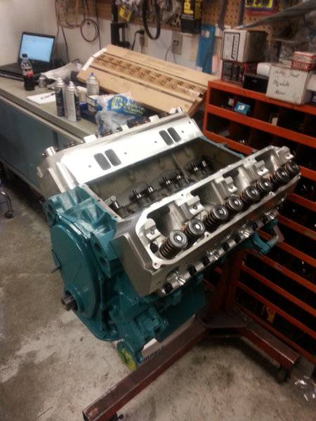

The machine shop had to deck the block 10 thou to get it square and true. Then they had to remove the same from the top of the piston for 0 deck. I'm hoping I can still run a 1.6 rocker set up. I have seen some test that going from a 1.5 to 1.6 doesn't seem to affect horse power much on these big strokers but I would still like to take advantage of the roller cam.
Its getting close to dyno time. Just need to get some push rods measured up and ordered. Then see what it's going to do on the dyno.

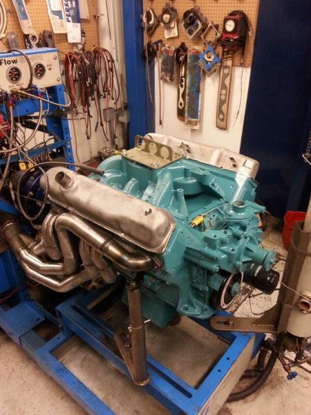

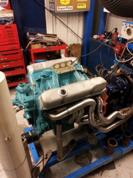

Well got the numbers from the dyno session today! The numbers are close to forty more than expected. So I'm very happy with the results. I took a video and will post it hopefully by the end of the weekend.

Good power, did you pull it any higher than 5500? Looks like it was still going
The shop did some higher pulls on break in the day before and said it was starting to nose over after 5500rpm. The horse power keep going up each run that we made today. Loosening up a bit on every run. The guys at the shop even seemed impressed by the numbers especially with the duel plane intake with no work done to it. Not even port matched.
I'm going to add because the right bank a/f ratio got cut off on my picture that it was running at 12.7 a/f ratio. I'm sure I read something before about BB mopar's will run lean on certain cylinders on opposite banks.
