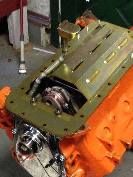

Sorry to hijack, but I have a related question...will a windage tray still fit with a main stud girdle?
On the normal ones that are sold, yes. You may have to do some trimming on the tray and tweak the pickup.
Hughs said a windage tray wasn`t needed w/ a girdle. A girdle will help w/ main cap walking, which could help control the block splitting between the cam and mains ," some". Wish I had the coin for a new alum. block myself. Shannons engineering has them for about $5000 !!Yes, and I would use one.
Hughs said a windage tray wasn`t needed w/ a girdle. !!
It acts like a partial windage tray it self. Oil slings around and gets caught on the under side of it and falls into the pan. A scraper would be more benficial .Please explain why.
The girdle does nothing for windage. It does act a little like a very poor scraper. Everyone that I know that uses a real scraper (i.e. 0.040" crank and rod clearance), along with their girdle, still use a windage tray also.It acts like a partial windage tray it self. Oil slings around and gets caught on the under side of it and falls into the pan. A scraper would be more benficial .
Who is building your engine? I'm not far from OttawaWell I’m going to listen to him. He’s built tons and competed in major engine competitions so I’ll let you know in a few years who was right.
