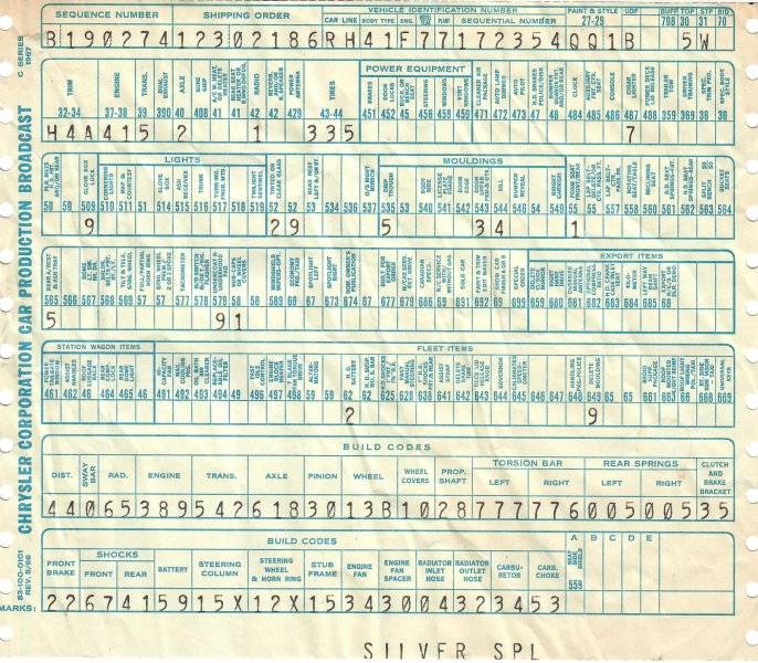

Here is the Broadcast sheet for 67 Belv Silver special from the St. Louis plant to compare printing fonts
This appears to be from station B and shows no spring marks, like the OPs sheet. Was it found in the upholstery or dash? it’s also from a different year.
Plants had many printer stations and printers per station. What happened at one printer may or may not be applicable to another printer or another year.
(FYI…..your car was built early compared to its SPD)
BS was found in a 67 Belv II 2 dr hdtp that I had many years ago. I found 3 different sheets in that car only 1 of which belonged to that particular car. I don't recall exactly where it was, but believe it was in the rear upper seat frame based on the lack of spring marks.
On the 4 67 B-bodies I have/had, I have found sheets under the rear carpet - usually in bad condition, in the springs of the rear lower seat and in the rear upper seat frame. I don't recall ever finding one above the glove box.

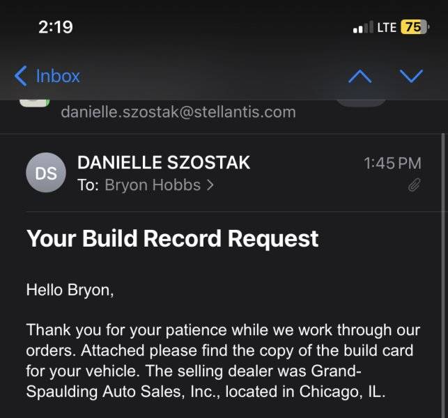

According to Chrysler historical it is a confirmed Grand Spaulding sold car Galen Govier is still doing research on the car currently Unfortunately Chrysler couldn’t find anything about them ever having produced the 426 Wedge in a 66 B Body
Great! So did you get a copy of the IBM card and would you like timely assistance with a decode?
If the IBM card looks like some form of a punch card yes they did send me a copy of it I’ve never had a car I actually got or looked for paperwork in so this is a bit different to me
Get with the guy in post 314 and send him a copy of the card so he can decode it for you.
