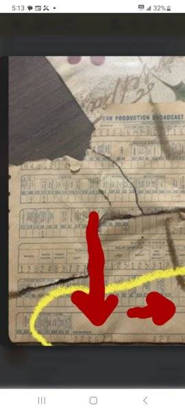

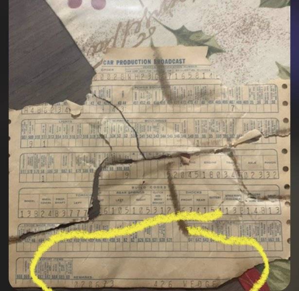

The build sheet says it plain and clear at the bottom, we are working on getting more documentation.

You’re managing to perfectly ignore the highlighted section at the bottom

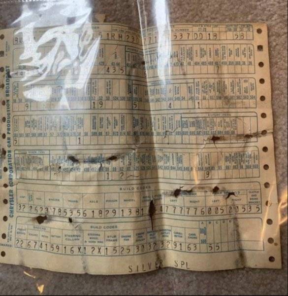

That claim would be the equivalent to saying this Belvedere 2 isn’t a silver special
True, this is the only piece of documentation this person has and everyone believes it’s a silver special, what’s the difference? I mean I get what you’re saying, all we have is a mere reference at the bottom, but isn’t this further proof?

The factory documents, both factory build sheets the car was set with, say special order 426 WEDGE, I’m just curious as to why the build sheet isn’t being considered a factory document, I mean I see what you’re saying, we don’t have the motor or anything other than the build sheet, but we have multiple mismatched signs, and a professional telling us this is a real 426 WEDGE car. We will work on documents and I will work on getting in contact with the original owners family, until then we still have a can of worms.

Choose to ignore the proof that’s been put in front of you or accept the evidence that has been presented even Chrysler themself telling us they couldn’t help us I’m not gonna fill up another 2 forum pages bickering and arguing about documentation that’s been presented plain as day

No dog in this fight - but there were 2 build sheets in the car with the same note - is that correct? I wonder what the significance of the 220673 out beside the note is, if any. Probably little way to find out.
edit: looks like Ramcharger just asked that.
