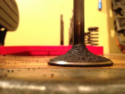

The heads will be template ported, stock valves will be backcutted. Also they will be cut down.004 to bump up the compression.

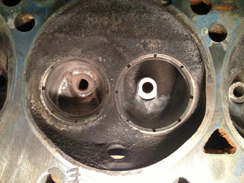

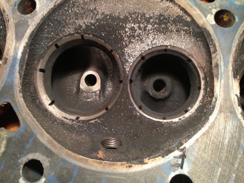

Template portjob done, 30 min/ port
