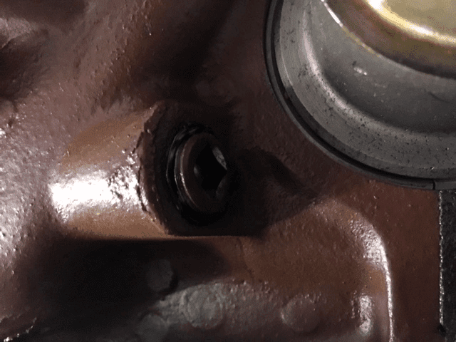

One problem I had and got no oil to the top of the engine was I missed a plug inside the timing cover that you have to put in from the bottom. I missed that plug and the oil pump would pump oil straight up. and then dump it right back into the oil pan.
This is easy to miss for first time engine guys. And I thought I was very thorough when I built the engine.. Just missed this plug. Its pretty much right above the cam hole behind the timing cover.
