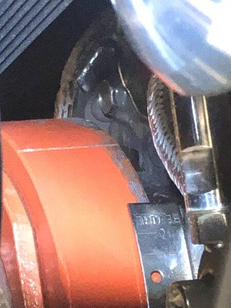

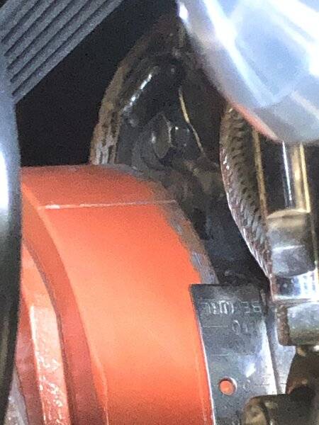

Damn, you hit the nail in the head. I haven't done anything to the distributor since I bought it but I think that limiter plate will help. the timing was around 13-15 so I pushed it to around 17 and it seems to be a little better. the idle still better around 950 and any lower will just be doing the same stuff (up-down)

The pictures are about the best I can get for now, it probably shows around 20 degrees and it seems to work better but the idle is between 900-980 or so. I think it may be what everyone is saying vacuum leak I just can't find it yet.
