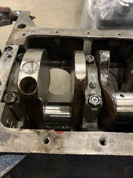

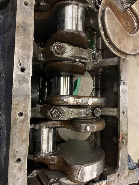

Some pics

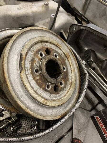

If you have a heavy "sixpack" rod motor, and a neutral balanced balancer, and no weight on the converter or flexplate.... yes that is your vibration problem.

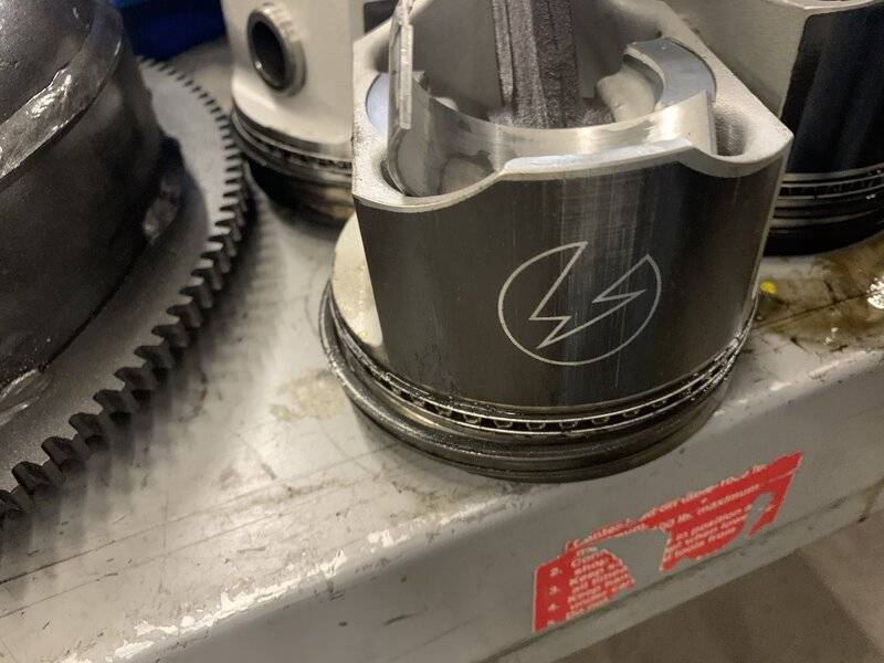

Show a side shot of the rods, cant see if they are the heavy rods or not. That is a steel crank, and it looks like a neutral balancer. Any weights on the inside of the balancer? (The rods that say LY on them are standard weight).
Edit: looked at the first piston pic again . Those ARE the heavy rods. If you dont find any added-on weights on the balancer and converter, i think that is your problem ( i have no way of knowing the weight of your pistons.)
Sorry not a great pic of rods. A friend that looked at them said same as you. They are heavy rods
Confidant that the balancer is a neutral balancer thanks to an earlier post by khryslerkid. No weights
