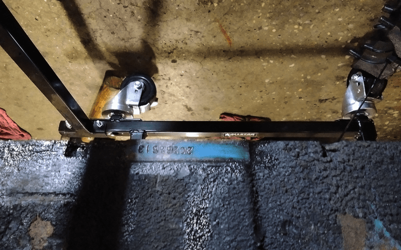

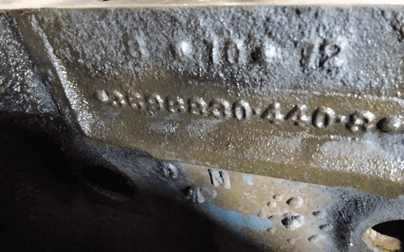

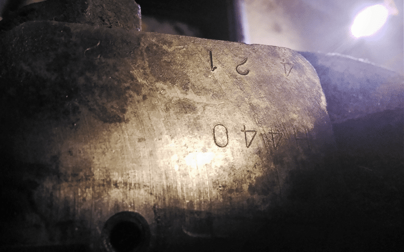

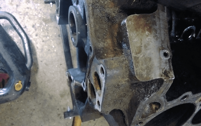

Yes. Didn't get the ones off the back yet.Got any photos or numbers off the block? It could be industrial 413. Reverse rotation is only from a boat.

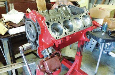

So the engine was not reverse rotation. What would be the reason for turnibg the csm in reverse? Eliminate the timing chain? And then build a one off cam. Doesn't make much sense. Maybe for an industrial pump motor on LPG or propane that runs constantly.@dvw he is trying to say that some engines had the only camshaft turning opposite direction.
And of corse there has been no year, make, model, or application given.
Manufacturing a 'one off' cam probably wasn't a big concern for Chrysler, since those engines also had different heads, intake and exhaust manifolds, pushrods, distributor, pistons, timing cover and oil pump compared to passenger car engines. One more extra part wasn't going to be a deal breaker.So the engine was not reverse rotation. What would be the reason for turnibg the csm in reverse? Eliminate the timing chain? And then build a one off cam. Doesn't make much sense. Maybe for an industrial pump motor on LPG or propane that runs constantly.
Doug
I think that pretty much nails it.Eliminate the timing chain?
Thanks R413. The seller had it tagged "72 440" as though the unit had been inventoried. If that is the case who knows for how long and with what else it'd been sitting. At first I wanted some valve covers from the same guy but somehow missed out. It turns out that the ones on this engine were good and maybe better. He did say it turns good. Al Callaway at Burtonsville Speed and Machine told me, "Well careful because sometimes that could mean they're worn out". I jumped. I'm glad I did.This shows us a 1972 440 from a C-body car. Good engine to have for your hotrod.
