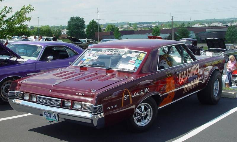

Might be a little extreme but if it turns out to be a reverse rotation engine, you could always make one of these.
:lol:
Yes, however that doesn't become obvious until after you have shifted your transmission to reverse and hit the gas but realize, "Hey, I might not be going anywhere"!...
Oh man....hit reverse lots of times while going forward....but did it on poipous :D
:lol:
Never really liked those....little bit too strange lol
