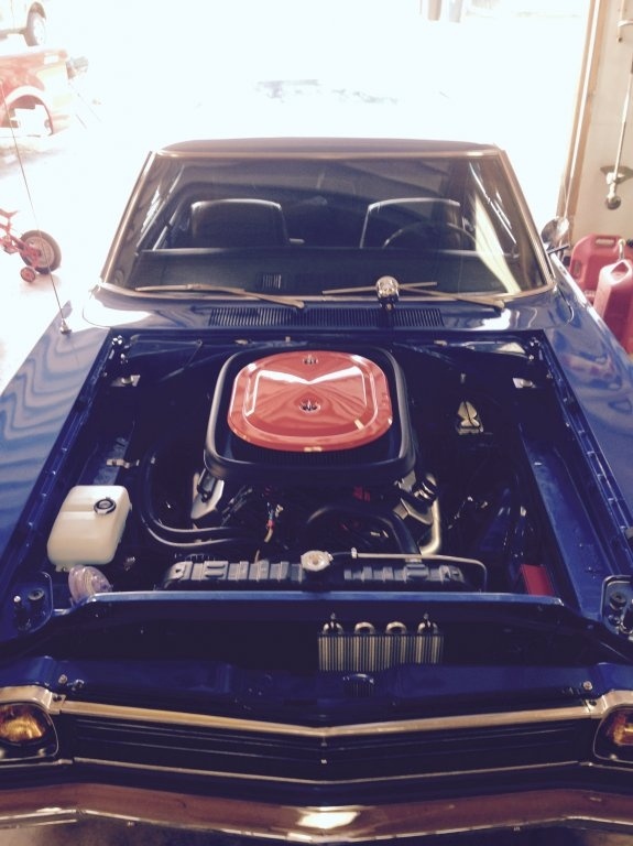

My cuda is strickly a street car. it's a shaker car so no max wedge heads and I kept the six pack. I love this thing on the street. Purrs like a kitten at 26-3 grand on the high way. 72 mph at 3 grand (410 gears - 29 inch tire with a hemi 4 spd).

My 511 (low deck) does quite well on the street. It hasent been on a trailer yet, even for going to the track. The cam and cylinder heads really dictate the street charistics. If I was running a road gear and a tight converter then my cam would be a bit much. I've been 10.9's through the mufflers with both a six pack and a single plane with a 1050 annular. Drive the car everywhere, and those heater hoses are not just for looks!!

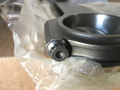

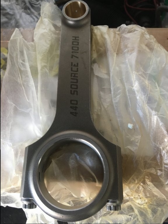

The source kits are 55 over not sure exact cubes with 4.250 crank and 7.1 rod but they work good... I've screwed a few together other than pin fit issues they are legit
Go with arp2000 rod bolt upgrade for only 75 bucks
Source kits have other issues. They are good value, but I've yet to have one (probably 10 kits over 10 years maybe?) that I considered ok to run out of the box. Rods are always a problem. Pins are always a problem. Cranks are always just barely within factory specs but always have taper and some out of round. Just a fact of life with lower price point parts.
I'm not saying they are ready out of the box at all just to be clear.
There great kits if your an engine builder and know what to check. I never consider any aftermarket part ready to run out of the box.
