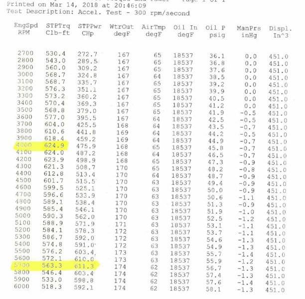

I put together a 451 B engine with TF240 heads and I had Tim @ Hughes help me pick out a cam and was very pleased. I also had one ground by Bullet and that did pretty good also. Had a few Hyd roller cams and they got into the 570 HP range and then Tim suggested a solid flat tappet for valve control. Let me tell you it picked up about 30 hp and a whole heap of torque. Tried a few tests on different engines 440,451,470,512 and hyd roller and solid flats. Every time we used a solid flat it just plain and simple did better that the hydr roller. Yeah have to adjust them once a year but it sounds great and the car pulls like a SOB. Lot less $$$$ also. And that's from a 451 with 10.75 compView attachment 634429

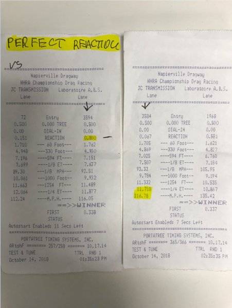

I got a chance to get to the track and try the car out and I am happy with the results. I still have some tuning to do but i'm on the right path. Car ran a 11:71 @ 116.75 and responded very well at the lights. I thinks it's ok for a 4100lbs car.
I got a chance to get to the track and try the car out and I am happy with the results. I still have some tuning to do but i'm on the right path. Car ran a 11:71 @ 116.75 and responded very well at the lights. I thinks it's ok for a 4100lbs car. View attachment 668430 View attachment 668442
Very nice. What was the DA at Napierville today? Like -400 ft?
DA?? if it's altitude it's 100
Density altitude. It's air density relative to standard atmospheric conditions and is represented as altitude relative to mean sea level. If the track is at 100 ft, and the air temp was 45° F, the the DA was likely a negative number.

Trick flow has built a stock stroke 440 making close to the numbers your looking for, 576TQ/ 620HP. The cam they used is a little aggressive for my needs. I want more vacuum for power brakes and to cruise at lower RPM than the cam they used would be happy with. Your needs may be different than mine. I still expect my build to be over 600#TQ and over 550 HP, and act like a mild built engine
Trick Flow PP240 top end kit info https://www.trickflow.com/parts/tfs-k616-620-576/documentation
Dyno chart https://static.trickflow.com/global/images/chartsguides/t/tfs-k616-620-576.pdf

Anywhere close to 600 HP is fine by me, but I sure would like a high, "flat" long torque line, and I really would like the peak numbers to be in the 650 ft lb range.
My hope is that this can all come in without ringing the neck of my motor, BUT it has to turn enough RPMs safely for me to cross the 1320 w/out shifting into 5th gear with my 4.10 ring and pinion gears.
Did you use the trick flow recommended cam? If so how does it idle? Does it make much vacuum?
I did use the trick flow recommended cam. It idles just fine around 1000 RPM. Doesn't make a whole lot of vacuum. But I'm super happy with the set up. I use mine for car show cruises and haven't even hit the track with it. I don't have power brakes or anything needing vacuum.
