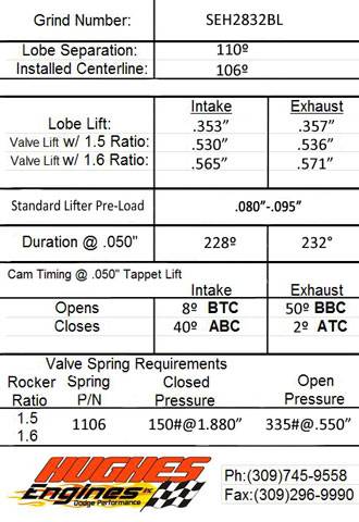

AndyF is there a book for finding the right timing curve. Kinda new at the game and just built a 470 with procomp heads and I believe the timing may be a culprit. The hughes cam (see attached cam card), Running 1.6 adjustable rockers with a qft 870 vac sec carb with a edelbrock rpm dual plane any help is greatly appreciated. Thanks in Advance. My current timing it 15 degrees at idle and 35 total all in at 2800rpms. i do have vac hooked up to distributor. also.
Building the correct timing curve for a performance engine takes a lot of patience, especially with an analog distributor. These days I use EFI with the computer controlling the ignition timing. That way you speed the whole process up. A Holley Sniper plus the matching Hyperspark distributor allows you to adjust the timing when the engine is running. (even driving down the road) When you can do that it becomes easy to find the timing curve that the engine likes. The old school method is just painful. Try different springs and weights until you get something that kind of works and call it good.

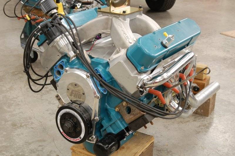

If I'm building a "nice" engine I'll use a Molnar 4.25 crank with Molnar 7.100 rods and then a high quality piston such as Diamond, JE, Wiseco, CP, etc. Use the Trick Flow 240 heads and a ported Trick Flow intake. (Hughes Engines does a nice deep port match) Holley Sniper and Hyperspark distributor. I'd go with a modest hyd roller cam for a street car. Maybe something around 240/246 at 0.050 with 0.550 to 0.600 lift. I'd probably use Comp rocker arms and Gaterman lifters. Those engines cost about $15,000 to build and they'll make 615 hp with 625 torque.
The Trick Flow top end kit is a decent deal so you can look into it. I wouldn't necessarily buy those parts if I was putting a kit together myself but that kit works. I've seen several engines built locally with the top end kit in it and they work pretty well.
