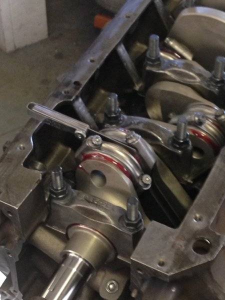

Good kits for the price. The balance job was fine on the two stroker engines I have. The first engine the machine shop shop "re-balanced" the kit and added weight to the crank. The engine vibrated. Took engine to another shop and they removes the weight the first shop installed putting the balance back to how the kit was delivered. So on the second stroker kit, I bought a good scale and rod balance fixture, and weighed all the parts, and verified the balance weight was the same as what the crank paper work came with. I put that engine together with the balance as delivered from 440 source, and it runs great, and no vibrations. I am helping Dan build a 505" stroker with the 440 stroker kit and the optional light weight crank. We will be checking the balance weights on that one too just to verify we come up with the same numbers. There are other things to check and maybe correct, like piston pin to rod fit, the rings are file to fit, and double check the bearing chamfer to make sure the bearing is not on the radius of the crank. If it is on the rods, you will have very little rod side clearance. If using a manual transmission, the hole in the rear of the crank for the input shaft bushing is not finished to size, so the hole needs to be finished to size for the bushing, or you can just use the roller type bearing.
