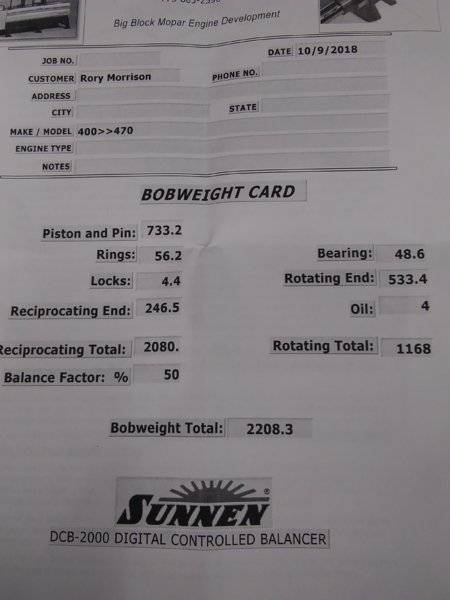

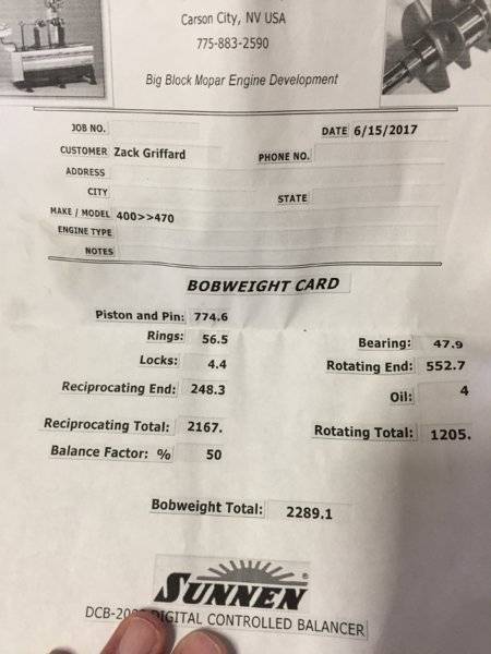

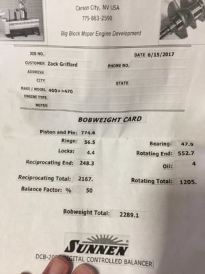

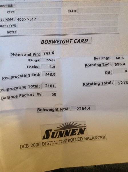

Here is the ballance sheet. Just got the kit.
Wanted to check piston weight but my old Dial a gram scale only goes to 600 grams. Don't see any grinding marks on the rods to weight match. Might take the whole shebang to the machine shop for shits and giggles. Othere than that looks like good stuff.
My kit is the -24 dish 40 over kit 400/512. The bearing weight is different so they are weighing every kit.
Here’s mine for my 470.

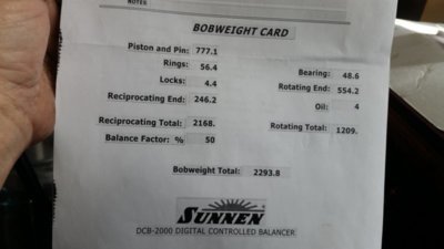

I didn't see any grind marks on the rods or pistons. The entire assembly is going to the machine shop this week to be double checked.
Mine is -4cc. Which should be heavier than the -17cc. However, without having a -17cc piston for comparison it's hard to say how much meat is below the domes.
