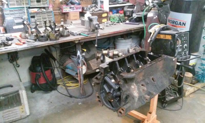

I've got the 383 stripped almost all the way down, but I worry if the cam and lifters are going to come out. They were right under that 30 year field mouse nest and that caused a good amount of rust on them. I'll try to get them tomorrow. Everything seems to look like this was a healthy stock motor when the car was parked. I haven't seen anything that was worn bad or broken.

Could someone explain to me how to figure out if this 383 is the #s matching original for my car? I cannot find the #s that I thought I needed to for checking it.

I wish that I could help you with the #s matching. I am still learning also. I would think that if the year and clock letters on the side of your block closely match the year and date of your car build that there is a good chance that it would be the original.
I think I've just about figured it out..
This site helped me.> http://www.moparts.org/Tech/Archive/motor/36.html
My motor has a casting date of 10-24-67 and an assembly date stamp of 11-22.. So since I can't find the matching last 8 vin #s stamp and there is no identification pad, that is because, according to that site, motors cast and assembled before 1-1-68 had no id pad or matching last 8 vin #s stamp. So apparently there is no absolute way to connect my motor to my car. But with all that said I'm 99% sure it's the motor that came in the car. If I'm not deducing all this correctly plz let me know. Further discussion, info, opinions, etc., on this will be welcome.
Exactly Amigo! 1969 cars, it's easy sailing matching the number's, but 1968 cars is Iffy, if even possible at all. Some plants did start stamping on 1968 models, some didn't...but that's when they started rolling out with stamping them. 1968 and prior cars....folks go by the build dates of the cars and engine to come up with a common deduction if it's the original motor or not. On those car's, folk's saying "numbers matching" actually wouldn't be correct. It would more like be "period correct". Can't match numbers if there isn't any there.
Yep, thats what I was thinking. I may check the build date on the car and the assembly date stamp on the motor. If they are close that would be proof enough for me and I would hope for anyone buying my car, in the far future., and wants the original motor with it.
And I did finish stripping it to bare block. I may vat it, clean it, lube it and bag it for storage.
I remember when the troopers asked me for the trans and motor ID #s, I thought my *** was had because there was no IDs on either one. Turns out missing #s was very common with the Mopars seeing how a person literally stood there and stamped each one by hand so they gave me the green light. Good choice on the 512, When I built my motor I knew everything I needed well in advance and scored as much as possible off of Ebay, scratch and dent sales, swap meats or wherever I could in an effort to save a few while I saved up the money. Good luck
