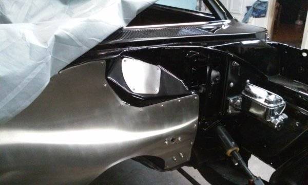

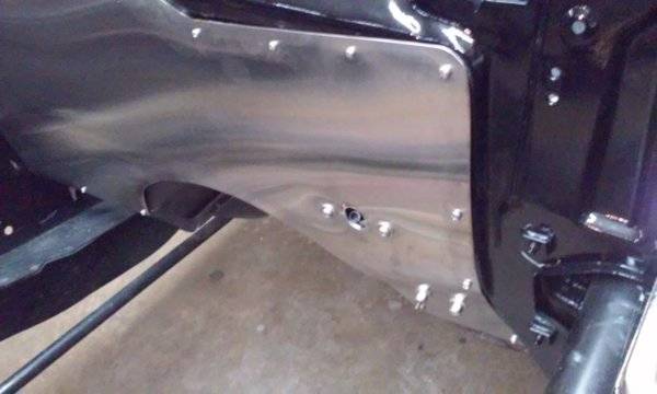

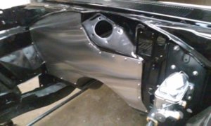

Figured I should finish and install the stainless firewall blank off panel before I install the dash since I'm fastening it with locknuts inside and they would be tuff with the dash in. Bought a piece of .032 ss for $45. I think it came out good. I'm gonna put seam sealer behind the ss panel to keep it from leaking and rattling. Gotta cut a couple more holes for throttle bracket.
Done.

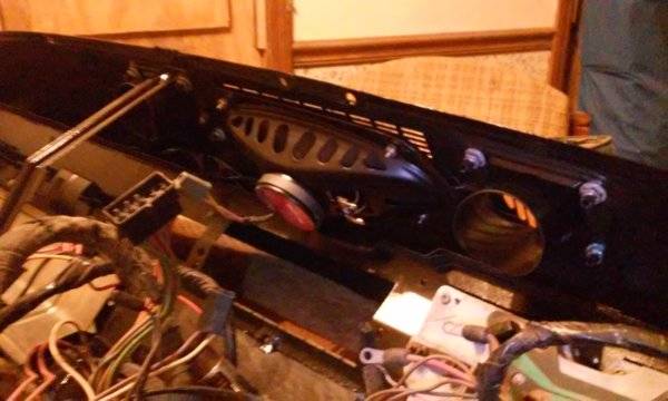

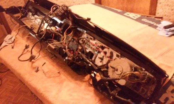

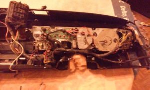

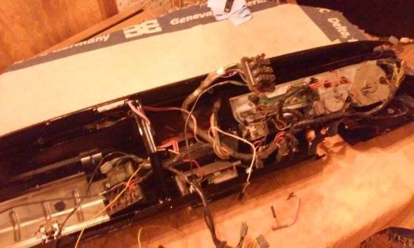

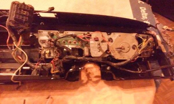

Started installing the dash harness. I have a diagram that I need to look at because this gauge cluster is a 69 and I think there may be a couple of differing connectors.
Good luck on the wiring. I have been putting my off because it scares me. I think that I have the least amount of confidence in the electrical wiring.
New harness or old? I will say pay very good attention to the circuit board runs and the pin connectors. I had a few that were wiggle loose and it caused all kind of problems. Also, there is a gasket between the metal cluster housing and the back of the round pin connectors. And replace the ammeter strip gasket so it doesn't compress and make contact with the cluster housing.
Other than that, the wiring is a breeze :)
Made a wiper motor delete plate out of some of the leftover ss. Anyone have experience putting led bulbs in a ralley dash? I'm thinking of trying some but they are so expensive I'm skeered of wasting money.

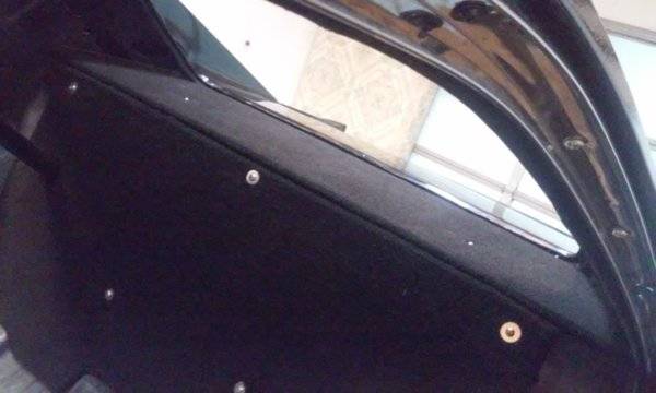

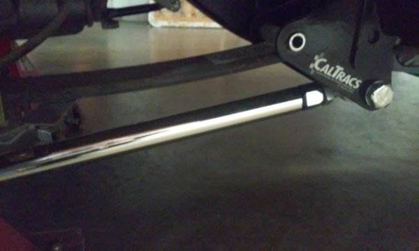

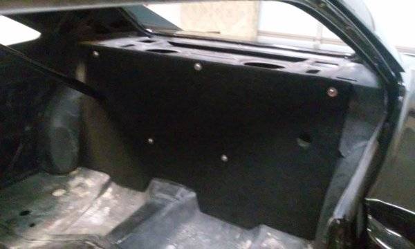

I finished the back seat delete panel with more of the black boat carpet. I going to make one for the package tray tomorrow. I also did a little something to the caltrac bars.

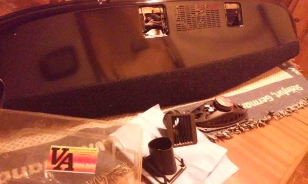

Got some goodies for the dash. I've gotten stuff from Van's Auto off ebay before and the quality seems to be pretty good. Funny how some of these parts are " Mopar- Authentic Restoration Products", made in Taiwan., lol.,That box had the lower dash side plates from windycitymusclecars.com. They are fine also, just still feels kinda crappy knowing my classic american muscle car was put back together with imported parts.

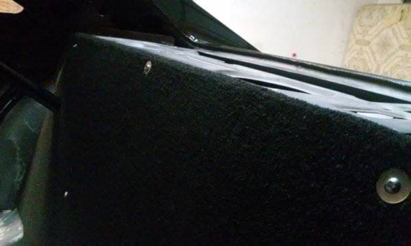

New speaker and defrost vents installed. Sorry to the purists but I can't bring myself to putting things back together with the flimsy stock stamped steel clip nuts and similar, so I'm using fiber locknuts everywhere I can in places that don't show, like the speaker. Hopefully using real locknuts instead will help prevent rattles.

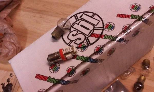

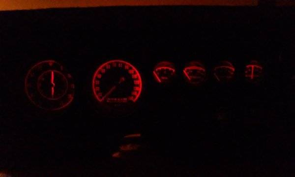

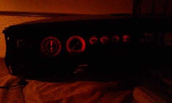

I put the red led lights in and lit up the gauge bulbs for bench test. Not sure if I like them or not., they're kinda dim. Funny, got them from superbrightleds.com. I did notice the lumens were lower on the colored ones. Kinda thought red dash lights would go along with the black car with red touches here and there thing.

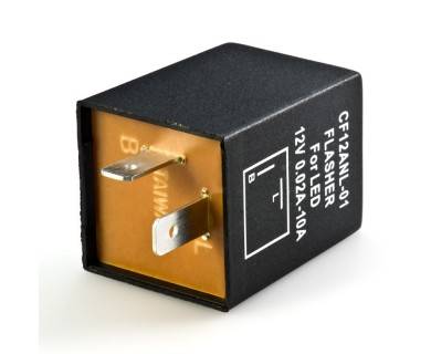

Daytona Kid - The gizmo that you need is to replace the current flasher with a solid state flasher.
https://www.superbrightleds.com/mor...12anl-01-led-bulb-electronic-flasher/781/835/
Should look like the one that you have in the car too:
They run $9.95 - and you'll have a full set of LEDs in the car - I love mine, they look great.
The reason that your current flasher will not work is because the LED have such a small amp draw, it cannot heat up the bi-metal element to cause it to break contact - then cool to make contact ( thus the flash ) so with the current flasher it would stay lit all the time and not flash. It's really pretty simple to get it installed - even plug into the existing wiring in the car too !

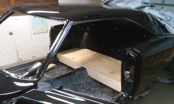

Will get one of those one day but my project funding is so low right now I even had to make my rear seat out of leftover lumber.
Since my rear seat was trash and since I ran the roll bars the way I did I thought I'd finish off the rear seat delete mod with this platform. I made it as low as I could and will put the good ole black boat carpet on it. May mount a NOS bottle on it, ice chest, fire bottle, etc.

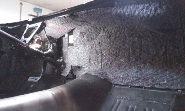

Just about ready to install the dash. I insulated the under dash and kick panel areas with some recycled wool and cotton flock blanket material. I like this stuff and will be using it for the rest of the under carpet insulation also.
