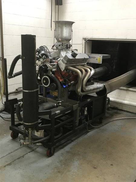

Here you go. This was a lot of work. Improvement could be made but it’s a cost vs gain scenario when renting dyno time.

What did you use for headers?
Thanks. They are a 2-1/8 dyno header with 16” long 4” collector. Kinda look like a sprint car header. The Superflow 901 dyno chassis doesn’t like the Mopar under chassis style headers.
