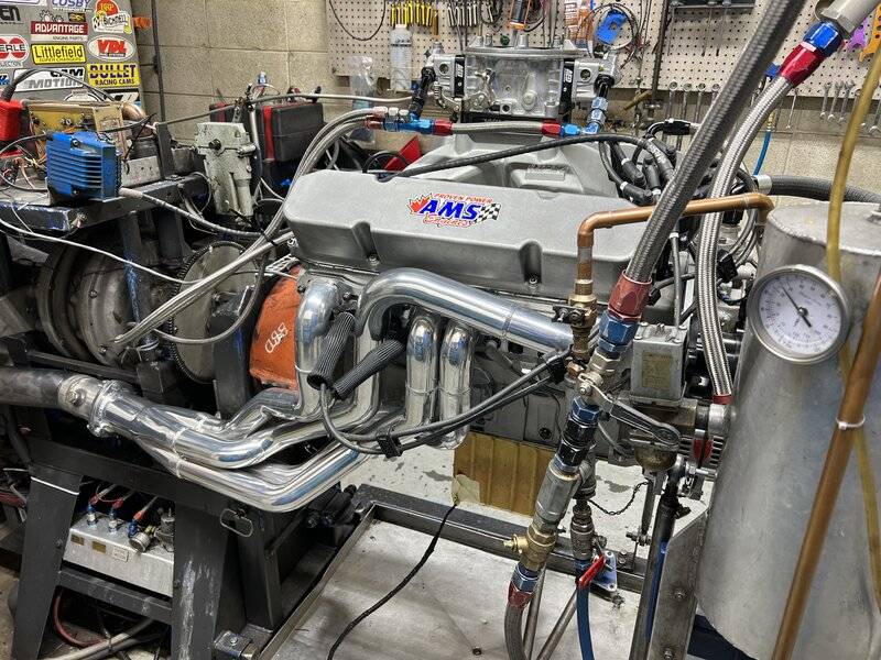

Big motor, smallish heads, small cam for the displacement, smallish headers, fairly high CR.
Should make a really nice TQ number, but I’d expect a fairly early HP peak to occur.
I’ve never tried an intake ported by Wilson, so that’s a wild card for me.

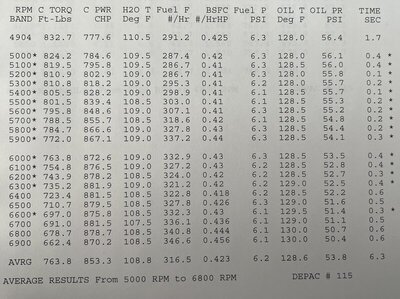

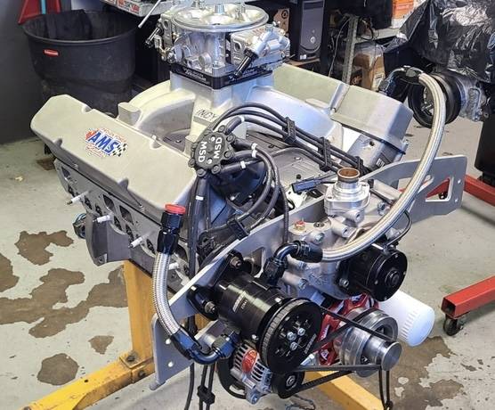

Actually only my low deck has a ported Wilson manifold. This Indy that is on the 572 is for the most part “as is” other then port matching and a bit of clean up in the runners.

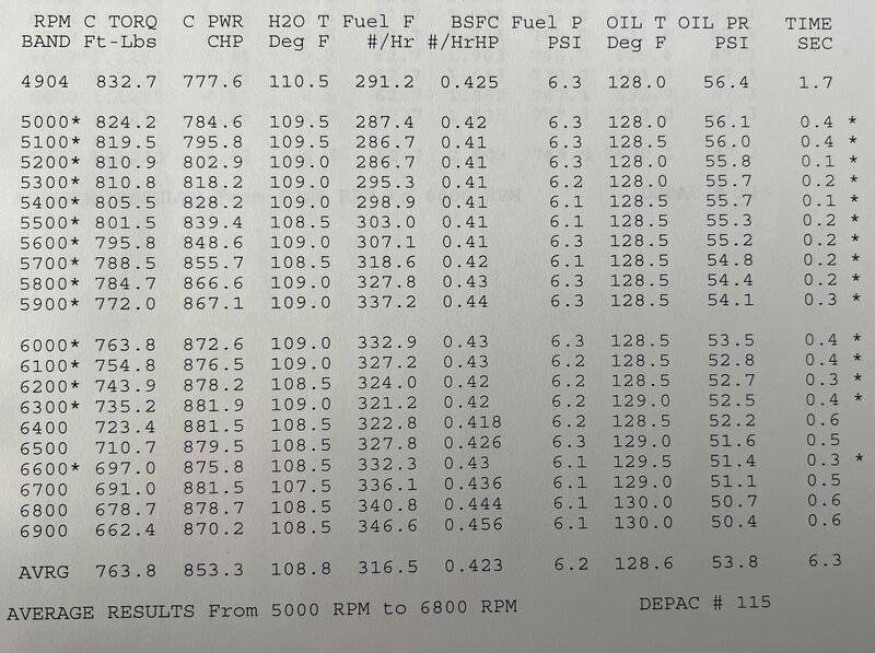

HP number guesses are close. Torque guesses are low.
For what is in the motor, it is about what I expected. The cam needs about 10 more degrees of duration and .080 more lift to make full use of the cylinder heads.
So looks like 833 ft lbs max torque and 882 HP max...
From what I can see and then surmise, torque and horsepower look like they have FAT (high) and fairly FLAT power curves. That's quite a machine you have to move Barney down the road! Congratulations!
