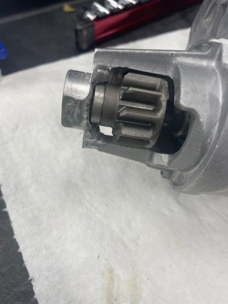

Well it was anti-climatic. One easy 14 second pass and then the car proceeded to break. Very bad noises coming from starter. Hope the damage is limited to the starter.

Need 3/8 more starter engagement. Only have 0.110". Wonder it ever started.
Several cars I’ve built required a trans to block spacer to get enough tooth engagement into the ring gear. 3/16” material usually does the trick. My current car has a spacer. Who knows why they stack up this way? Numerous converter Companies. Factory starter and trans.
Doug

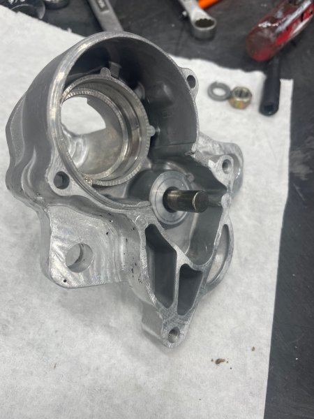

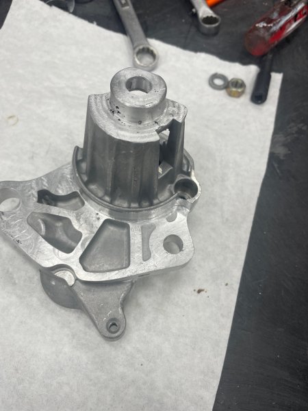

Well its fixed. Turns over just fine. Engagement is around 0.350". Was hoping for a tad more, but I will take it. Clearance between the starter gear and flywheel teeth is around 0.150". Target is 0.125".
The repair was not for the faint hearted. The casting was awful - terrible contamination while welding. Took 0.325" off the face and had to redo the snout also.
