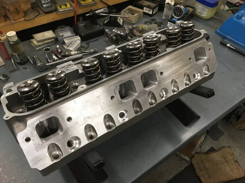

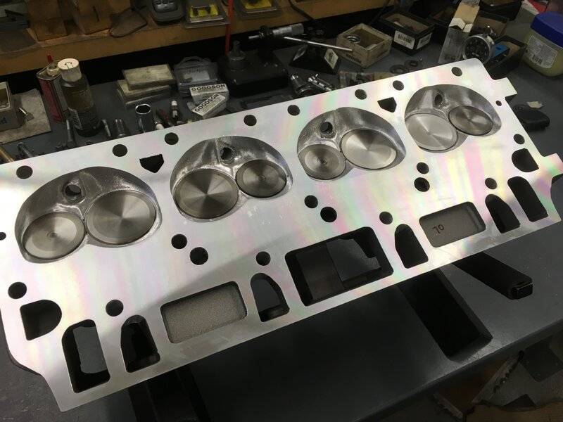

Are the heads basically the same as they were when you ran them before?
They are exactly as I got them from you. 0 changes. They only had dyno pulls on them. I ran the EZ-1’s on the 511 the last few seasons. So they are basically new off your bench.

My avatar might look familiar then. :steering:
That’s a photo of my -1? Cool.
Yup.
44DB36C8-7A74-41C3-B32D-BDF30D1A5F96.jpeg 3F4CDF4D-F2A4-4A61-890B-79838C773DE4.jpeg

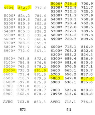

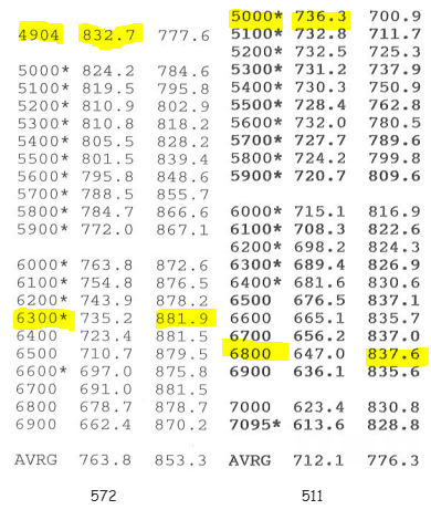

Were the guys that built it happy with it?
Yeah, for not being a perfectly matched combo, they were impressed with the power it made. It’s basically 60HP across the entire curve better then the 511.
I asked Louie what he would of done for a cam to fit the combo better? He figures a slightly bigger LSA and a mid 270 range pushing high .700 lift would really bring it alive.
We tested with C16, but he figures C14 would be a better fit for that motor. We didn’t have any to test with. Fuel is a bit of a challenge in western Canada right now.
My vac pump is a little weak as well. So a bit more vacuum would probably help a bit more too!
I do have a victor manifold we were going to try as well. Their machinist got COVID though and didn’t get it cut before the dyno.
The motor really picked up with the 2” spacer, suggesting the bigger Indy manifold works better then the smaller Victor I also have. So I probably won’t even bother testing the Victor at the track.

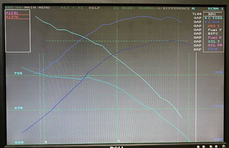

511 and 572 curve graph over each other.
Similar looking shape to the curves from what I can tell. Looks like the 572 has more torque gain than HP gain up to about 5600, (I will see if you posted lower RPM TQ and HP data) torque seems to fall at a little steeper rate w/the 572 above 6600...
My inexperienced .02..
I'm really curious what the dip in HP and TQ is at 6600 w/the 572?
