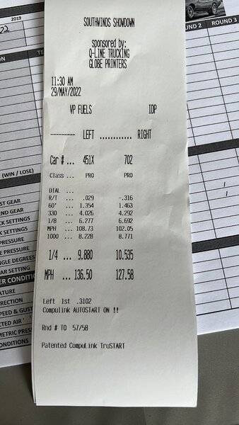

Through full exhaust, got it dialed in to a 10.007 at 134.57. 4500 air density. Muggy day.
No scolding from the track officials?
Does it “feel” much different?
Speed and ET match up pretty well.

I went WAY conservative first Pass and it ran a 10.51. So I pulled the ET Genie and put the taper spacer back in because I didn’t think it would pick up 6/10ths! Well it did LOL.
Put the ET Genie back in and opened it right up. It ran a 9.98. About a 1/10th difference from the taper.
7 turns on the Genie and it ran the 10.00 in 3700 air density.
All through 3” exhaust. So on good air days I’ll need to tweak some yet.
Quite happy with it so far.
