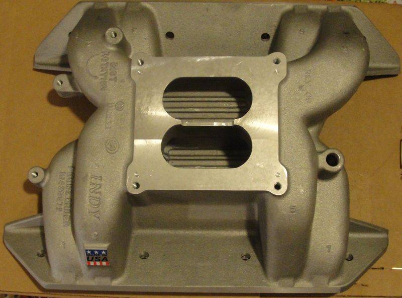

IMO I would start with the manifold, Edelbrock makes a nice more street friendly Dual plane manifold (performer RPM) that will give you more Bottom end (seat of your paints power) then a 750 carburetor or your current TM6, another Great manifold my personal all time favorite, is the Indy Dual Plane mid rise manifold, plus with a 1" spacer, another great way to tune your car is with a AFR gauge OMG this gauge can help you dial / tune your carb like a pro No B.S BTW a 750 wont hurt but I believe you will see better performance from a manifold up Grade & a 750 with your AFR.

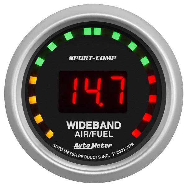

I will try the AFR gauge....and BTW, to ALL who are responding to my post: If I MISS responding to you I apologize. I've received SO MANY good responses!Here's the one I'm using in my car:https://www.summitracing.com/parts/atm-3379/overview/
