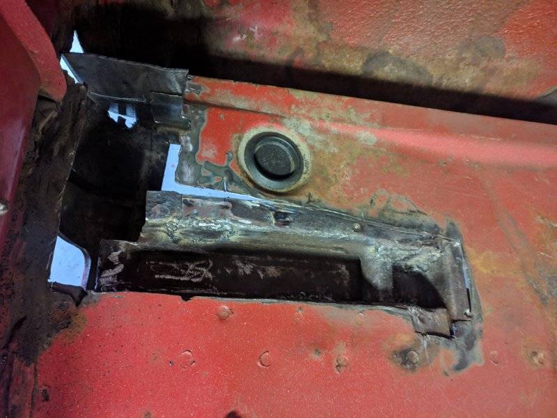

Flus core works better on thicker material in my experience. Others may have opposite. Add in that you are working with rusty 18ga that is probably way thinner due to the rust factor. Like you may actually be working with shim stock when it gets down to it. I learned how to gas weld, when I was a kid, by repairing 30 year old irrigation pipe that was in the dirt. Fun stuff.

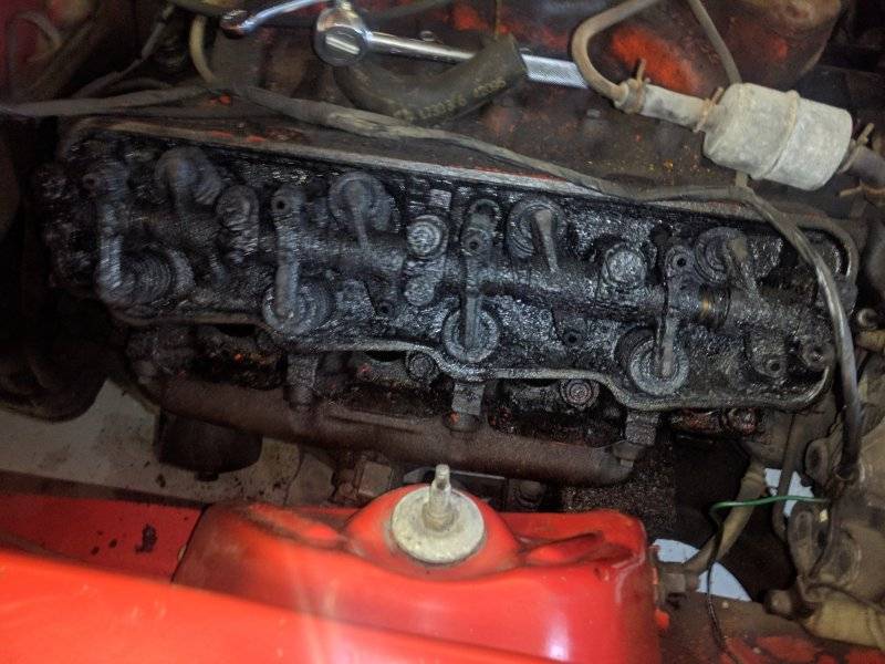

That engine needs rebuilt. It looks like it's never had an oil change and was only driven short distances, or something.Pulled the valve covers tonight to check for stuck valves and she's a dirty girl I am pretty sure this motor will have to come out but no harm in trying.. 3 cyls are holding oil still so they are pretty sealed up. Gonna keep soaking and trying things while fixing the body/chassis, another week or so and i will pull the heads and go from there. Sludge looks worse than it is... 106k miles, could be worse.

That engine needs rebuilt. Ot looks like it's never had an oil change and was only driven short distances, or something.

I popped the intake today and OMG it's 10x worse inside, you can barely even see the dist drive, it's crazy...Holy crap that is a dirty engine! The 383 will be a nice upgrade.

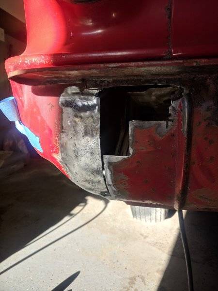

Looking good.Finally started adding metal back last night... first piece is just a old piece of 16ga i had laying around, i got some new sheets of 18ga now and it's sooo much easier to work The new welder was sooo worth buying, such a difference from my old one, might get the lift tig adapter to try that later one. BTW, grinding welds SUCKS.. but i learned a bit, should get better as i go.

P.P.S. I should have seprarated the valance and quarter completely but it will be ok when i'm done (i hope)
