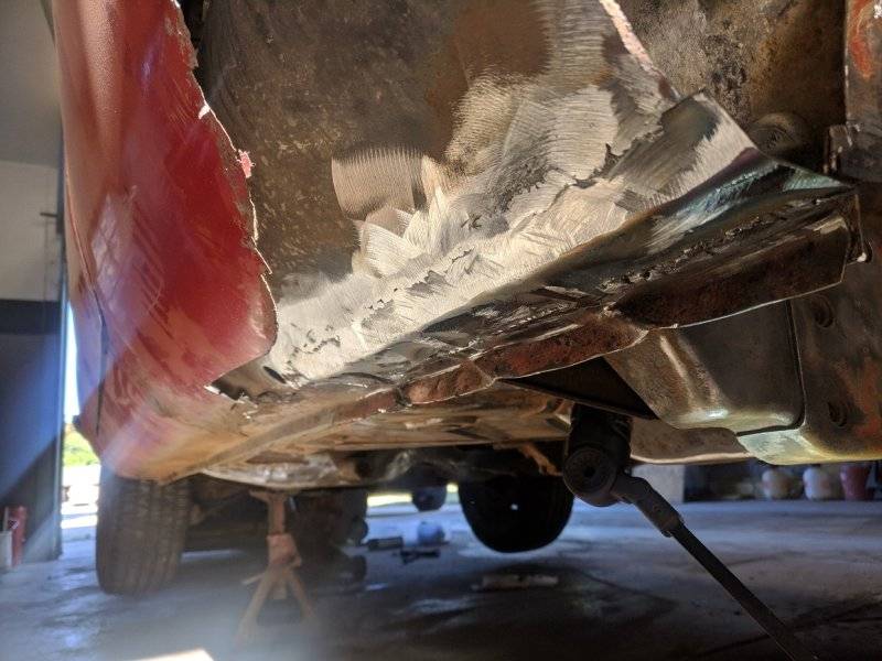

Spent last night with a propane torch and putty knife getting undercoating out of the wheel wells (Goo away didn't do a thing) torch works super fast then a quick run over it with a paint remover wheel and they look like new

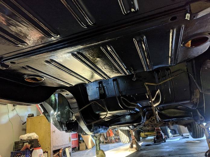

I am curious.. do you guys mostly do gloss/satin black in the wells or trunk liner/undercoat?

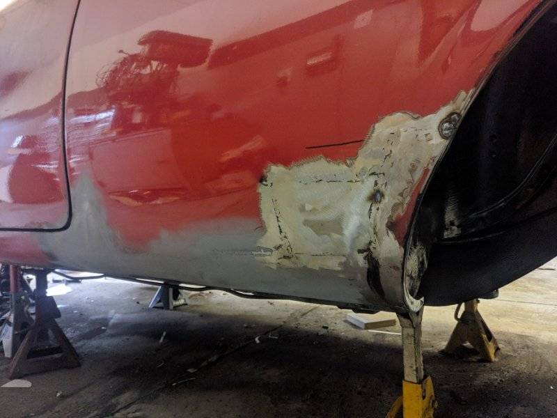

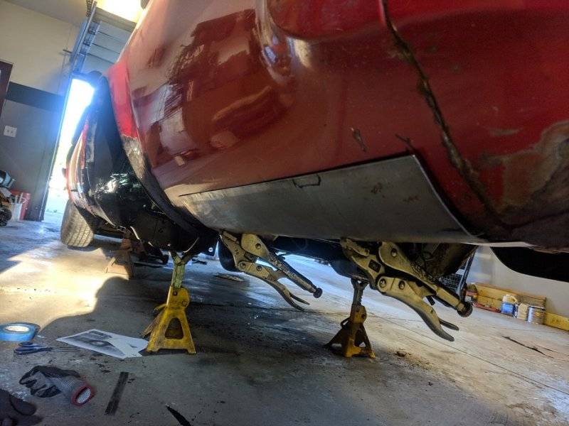

Got a bit of the well lips re-made, i need to figure how to make them look more stock though, they are so flat/smooth it looks like the inside of a 50gal barrel..
