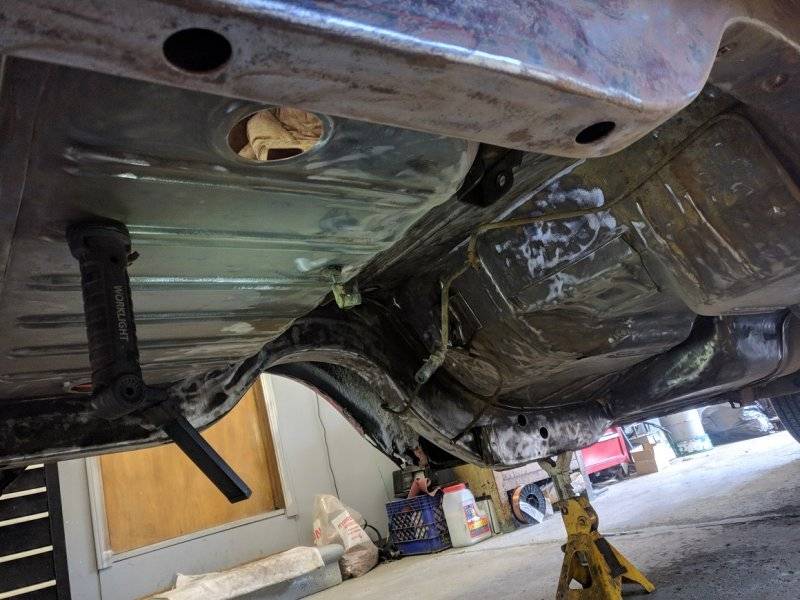

To remove undercoat, spray on automotive Goo Gone, walk away, come back 24hrs later, dried up and scrapes off .

yeah, i threw away like 5 of them years agoRemoving old undercoat, buy a needle scaler. Cheap.
