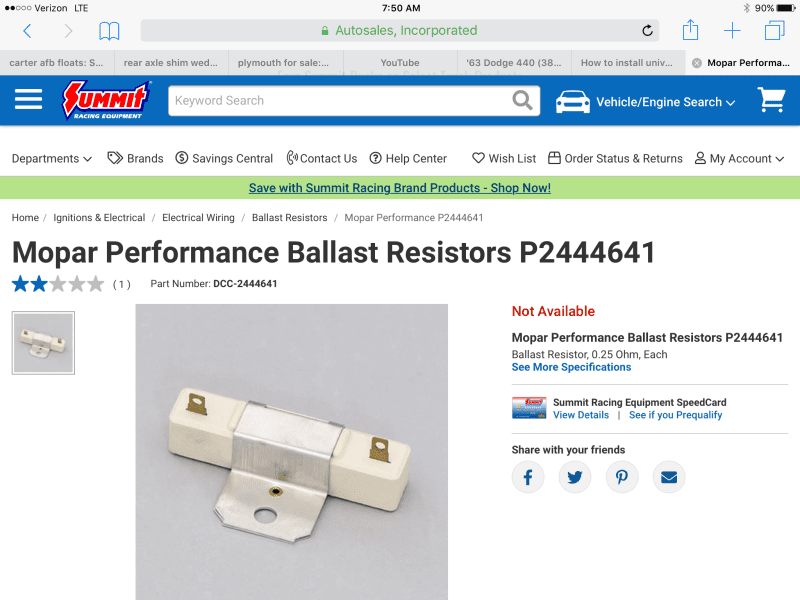

Oh yeah them why do they list them? .25 .04 1/4 the point is it's the same I'm running this one on my car and think msd makes that one two with the 1/4 ohm

post #3 &#7. Nobody makes a 0.04 or 0.08 ohm BR.
Just looked at the Blaster 2 instructions. Requires a 0.8 ohm BR, not 0.08 ohm.
Ok I put the numbers in wrong so 0.25 ohms and 0.80 ohms so it's my mistake .
