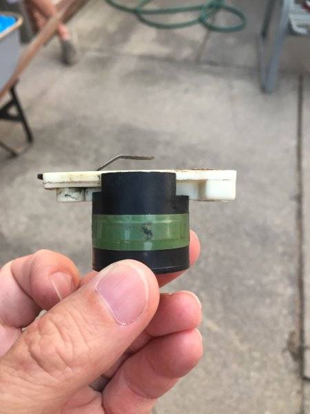

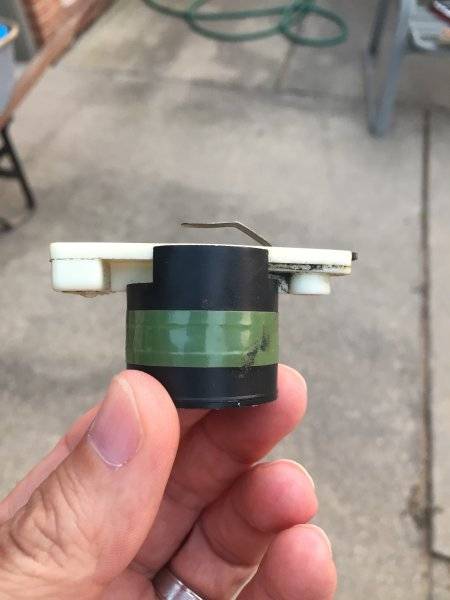

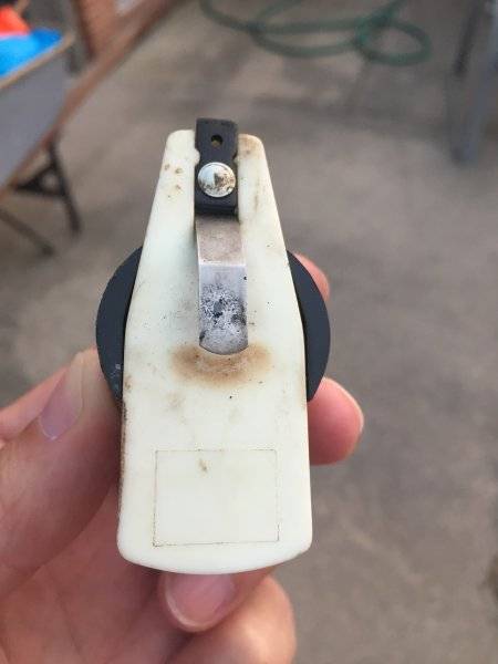

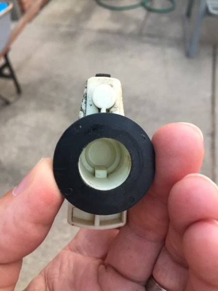

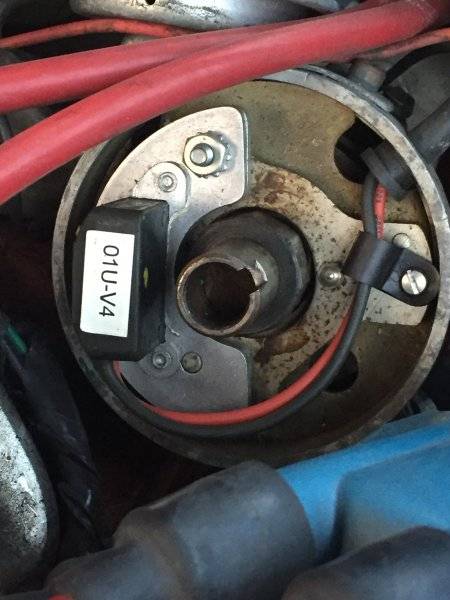

Sadly, Pertronix is the only information he has on the ignition system. He bought the car with the conversion done by the previous owner.
He sent a couple of pictures that may help

Thats either the Pertronix 1 or 11 Igniter Conversion kit for a points distributor
Hopefully someone can confirm that number on top to verify
Is there a sticker on the opposite side ?
NO Ballast Resistor required with either
Full 12 Volts for that system
Next , what coil is he running
