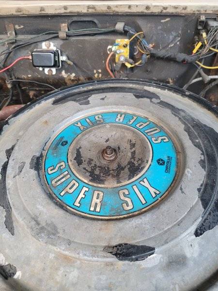

Oh, right. My bad. Everybody loves a picture or 5!
