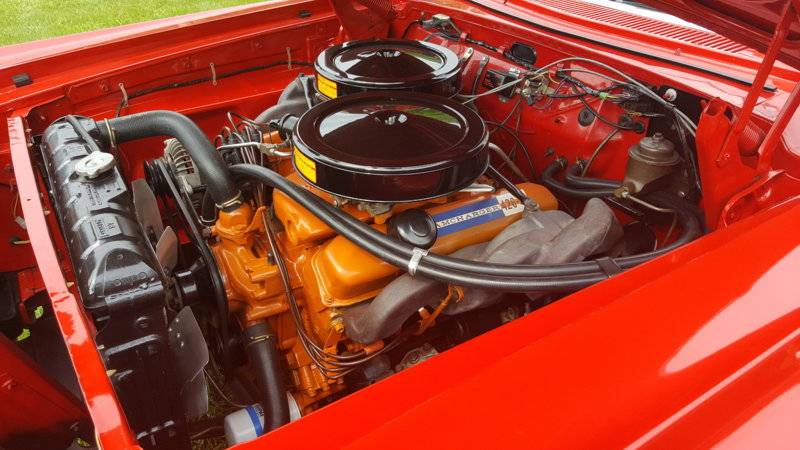

The 413 was around with its standard port heads a few years before 1962. In 62 when the 413 Max Wedge was released they added new heads with much larger ports and new pistons for 11.0 or 13.5 comp. Also the crossram with the 2 carbs and the new solid lifter cam. And better valve springs were added. Also the cool exh manifolds and exh system. So the 413 Max Wedge was nothing like the standard 413 with small port heads and it's hydraulic cam. At that time there was no Stage names given to it. They just called it the SuperStock 413 for Ply or the Ramcharger 413 for Dodge.

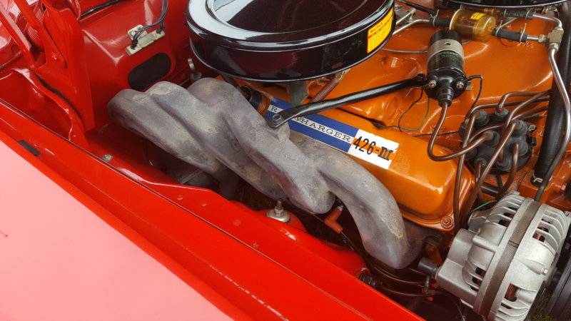

In 1963 it was bored to 426 cubes and was basically the same for the rest of the eng and of course it was called the 426 SuperStock or 426 Ramcharger. Then in the middle of 63 they did some head work to flow better and added larger carbs and a bigger cam.
That is when the Stage name came about as Ply called it the SuperStock 426 Stage II and Dodge actually called it the Ramcharger 426-A but everyone else called it a 426 Stage II. The Ply valve cover said 426 II and the Dodge valve cover said 426-A.
Then in 1964 they did more head work and added a better cam so they called it the Stage III. All 64 Max Wedges were Stage III and no 62 or 63's were Stage III's.

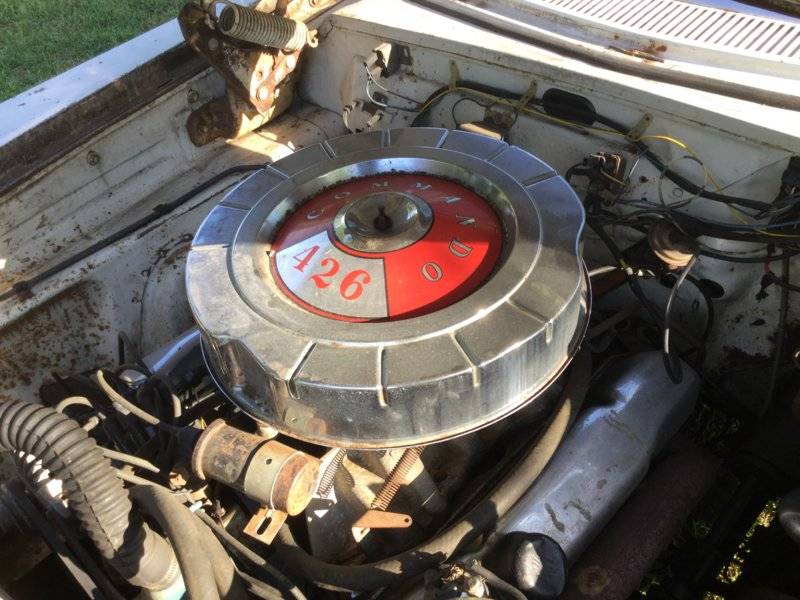

So thats why in 1964 they just took the good old standard port head 413 with the small hydraulic cam and its single AFB car with an auto choke and bored it out to 426 cubes. This was built to be driven on the street as it was very easy to drive as a normal car. Thats why the 426 street wedge is in no way anywhere near what a Max Wedge eng was. The 426 street wedge was 365 HP and did not come out until 1964 and was also in the 1965 cars. There was no Max Wedge after 1964 but many people think when they see a 426 street wedge in a 1965 car that they may have a Max Wedge car. But they dont as they just have a mild street wedge.
