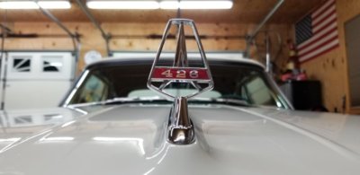

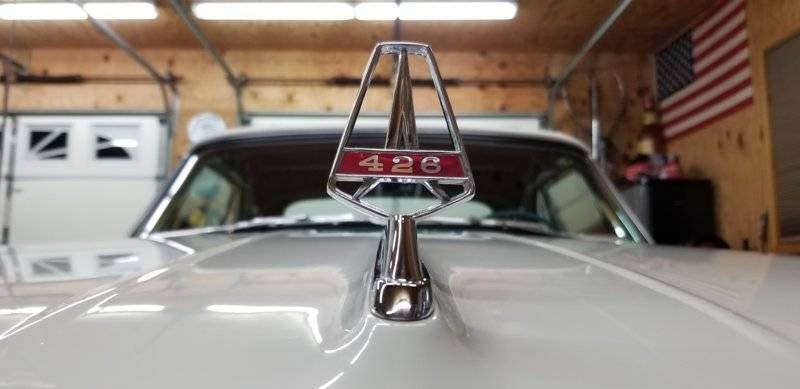

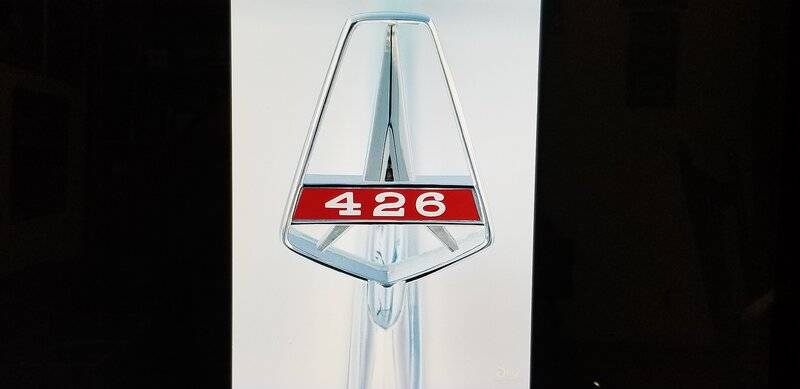

yes there was a street option 426 single 4 bbl in 1964 but did not have the heads/cam etc of the race engine. I was asked to evaluate a NEW '64 Plymouth with that engine and 4 speed trans, it would have been much better with an auto trans. still a heck of a street ride. if it was a factory street 426 the hood ornament would have said 426.

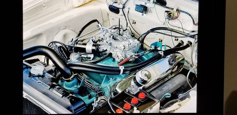

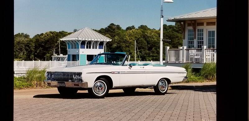

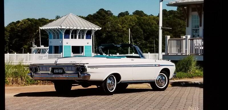

definitely an option, drove a new one in '64 with 4 speed, pretty cool car too.I just found a site that lists a 64 Dodge as available with a 426 wedge single four barrel, 375 HP and 465 LBTQ at 5600 rpm. Anyone know for sure if this was an option, driving Me crazy trying to verify a singe 4 barrel 426 in a 64 Dodge.
The lady I just bought this car from swears her brother, who owned the car and bought it second hand in 1966 from the original dealership it was sold from, is a 426 car, and He parked after high school, aroung 67-68. Maybe a dealer installed motor?
the hood ornament said 426 the race version with 426 engine was blank.definitely an option, drove a new one in '64 with 4 speed, pretty cool car too.
