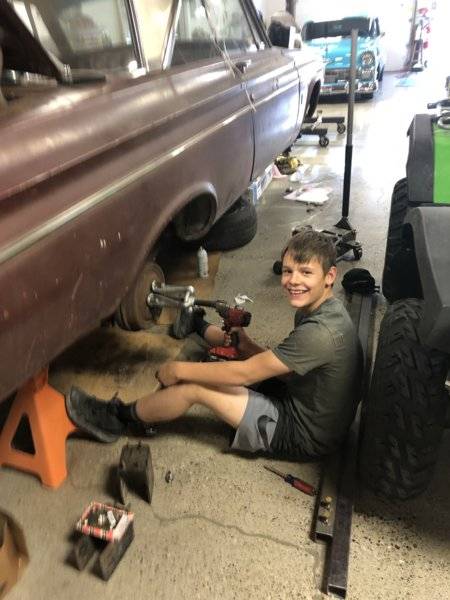

That's brilliant, I love it!View attachment 886763
I made my grandson remove mine. It’s a lot easier that way.
