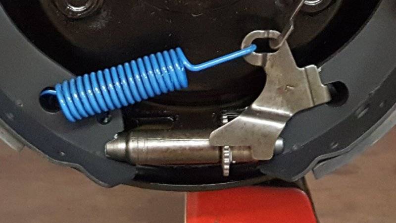

Having adifficult time trying to back off the brake adjuster star wheel so I can work on getting the drum off. I know there is a lock tab that needs to be pushed in so as to be able to turn the star wheel in the proper direction.
More than likely you have this style. Take a small flashlight and look in the adjuster hole. You can stick a small screwdriver in the backing plate hole to push it away from the star wheel, then turn the adjuster with a brake spoon or a sharp screwdriver.
