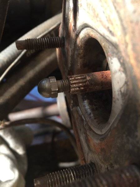

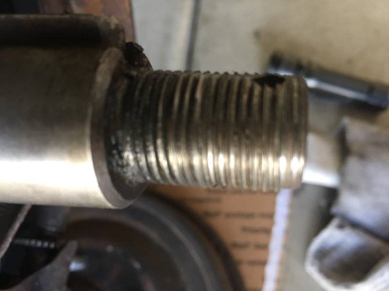

Need a thread cutting tool or a big thread file. Sure it is axle or nut?
Heavy duty 1/2” drive....I can see where the axle threads are kind of smashed up
Got the master bled and hooked back up to the brake line, but now will not mount to the booster, looks like that pushrod is sticking out too far. How do I get the pushrod back to where I suspect it popped out of, as it will not go back any further.
Problems solved......for now, thanks to my neighbor, Mopar owner and enthusiast with excellent eyesight, who was able to file down the threads for me. Also figured out it was the stiff brake line holding the master back from full insertion. Now all that is left (hopefully) is bleed the brakes.

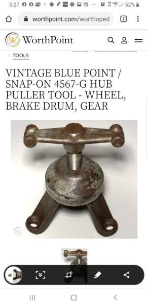

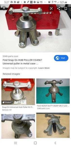

Personally I would opt for one of the more heavy duty pullers instead of the one in the photo above. That is a newer version of the tool I have... and I may be incorrect but I think the original has a larger diameter threaded rod and is just more durable in general
The old blue point and snap on ones are really big tools in person... the threaded rod is about 1 inch thick or more... they are very high quality and make the job easy. You beat on the ends with a hammer until you hear the loud "pop" that is described above and then the hub will come right off.
They may look similar but note the giant mass in the center where the arms attach to body of the toolView attachment 886664 View attachment 886665
That is the good one.
