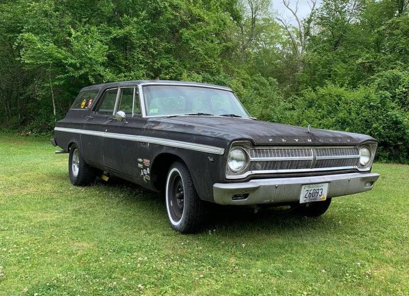

I`d like to see pics of that 65 wagon too...
Electrical is a weak point with me. That's why I ask a lot of questions.
