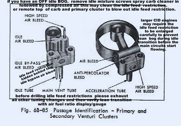

The low speed jet is part of the primary booster venturii assembly in both rear (primary) carb and the front (secondary) carb is NOT readily adjustable....the fuel metering orifice can be enlarged slightly but reducing it requires resoldering it and redrilling smaller....not recommend. Just my opinion.

Also, where is the low speed jet located?

Yes 380 is .080 so your jetting and rods look fine. As Bob stated idle jet on primary venturi. Picture shows it as idle tube.

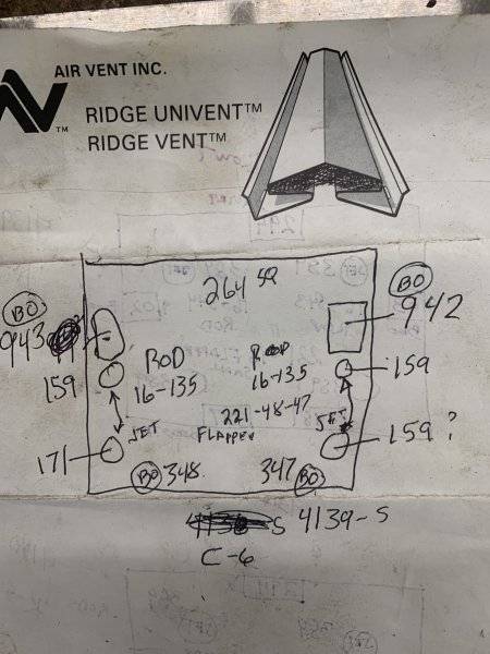

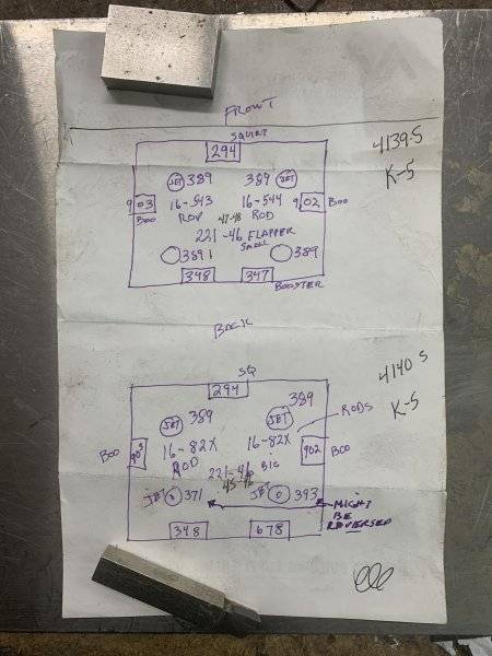

Thought I’d add what my two has in them, pretty sure it is the Chrysler race upgrade kit, I’ll be leaving them like they come, I also have a stock front one to go by if they don’t work well. 4139s and 4140s k5 build.
The boosters have no snivies.
The Race set up included larger jets and different rods and was meant to be used with a Vanke Modified manifold for racing. So distribution was different. You have a miss match of parts. Street 66 jetting with emissions rods from 69 up carbs. With Vanke mod primary boosters. If your using a street manifold your distribution will not be optimized.
